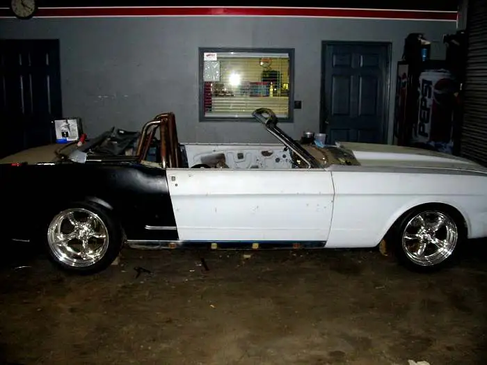

Plenty of surgery has been done thus far...
attachment.php
That is some serious rectangular steel tubing. The forward most piece has the roll bars mounted to it, and then there are a pair of forward tubes going into the convertible "underseat" panels. Also, there will be "low" door bars going forward from the outside of that rear bar, which will then tie into the dash bar and the loops going through the firewall and then down to the frame rails. Also a loop around the top of the radiator.
My engine builder is guaranteeing 750+ [flywheel] hp from the blown 408W he is building. I trust him...Just call it the pretzel car if the bracing isn't enough.
Here is the car with wheels under it

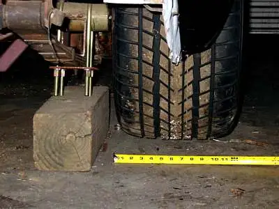

12" of rear tire [haven't got the new springs or other stuff worked out]:
