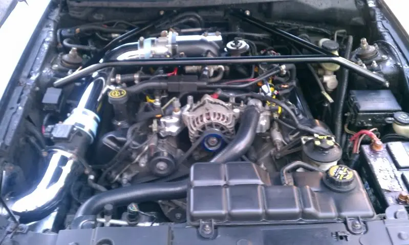

I am going with the BBK 78 mm intake

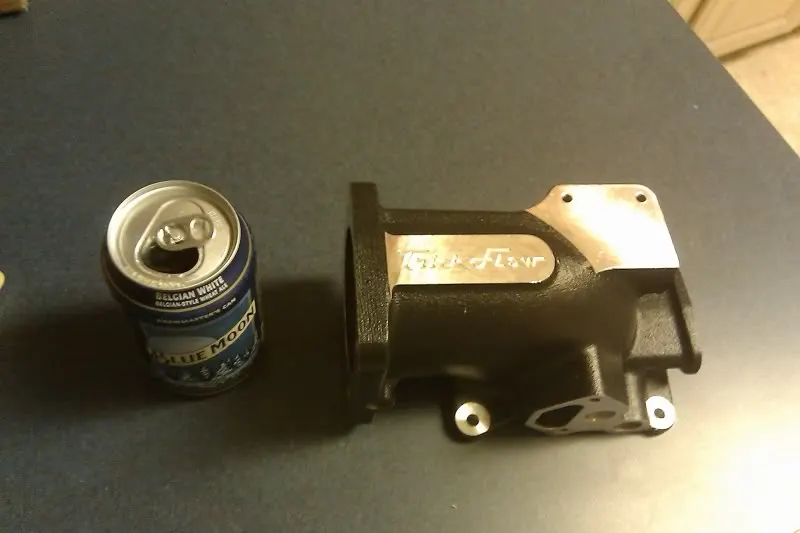

I just put a 75mm trickflow plenum and tb on my car around january and i've been very pleased with it so far. Sure i didn't gain 1000000000hp, but it's pretty much the last bolt on I had to do besides a blower or cams. If you do end up going the trickflow route, hit up Rick91GT, he's the owner of RNH Performance. Guarentee you he will give you the best price, and the best service out of any company...

That looks really good. Btw I didn't know Blue Moon came in aluminum cans...
I didn't either until someone gave them to me. I'll never turn down free beer, ever.
