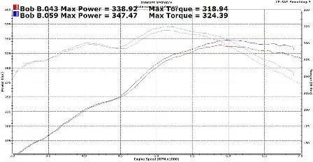

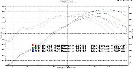

From the Anderson Ford Motorsports website:
(Requires adapter for use with 94-95 throttle bodies)
Holley says:
This Ford EFI passenger car manifold was developed by Holley for its SysteMax II Ford performance package. Don't be fooled by its California emission-legal designation. This manifold will flow like no other street/strip manifold. It's fully machined and ready to bolt down on any engine.
* 2000-6500 RPM power band
* Retains stock injector and water outlet locations
* External EGR passage maximized port and runner sizes
* Maximum unrestricted airflow
* Lower manifold parts match up to Holley cylinder head
* Special shiny finish
We say:
The SysteMax II intake manifold is the best we have ever tested to 6500 rpms for 302/331 c.i. natural aspirated combinations.
For forced induction the SysteMax II intake manifold with 302/347 c.i. combinations is one of the best if not the best up to 6700rpms.
SysteMax II intake manifolds is the most used intake in NMRA Pure Street and Renegade classes.
Tested on Mustang with DSS short block, Twisted Wedge heads, Anderson N-61 camshaft,
Bassani 1 5/8 to 1 3/4 step tube headers, Anderson AF-0112C Power Pipe 77mm Pro-M
Run 018 Ford Racing Cobra Intake
Run 012 Edelbrock Perfomer RPM intake
Run 035 Holley SysteMax II intake
Holley_intake_BJ_small
Only change between dyo pulls was intake
Run 043 Trick Flow Track intake
Run 059 Holley SysteMax II intake
Holley_Systemax_Bob_B_small
