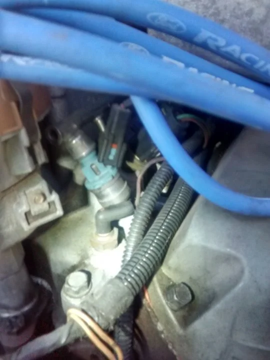

ok. first thing first
as mentioned check the color of the injectors. If they are orange/yellow they are 19#, if blue 24#. Also check the EEC, located in the passenger kick panel. It will have a large sticker on it that says A9L, A9P, are for a stock 58MM mustang MAF with 19# injectors X3Z is for the Cobra with a 70MM MAF and 24# injectors . You car will not run correctly with larger injectors/MAF and the stock EEC or vice versa.
For a CAI the stock CAI with a K&N panel fileter works about as well as any aftetermarket one. Most people install aftermarket CAI for the looks. On an otherwise stock motor, save your money and put on the stock part with the K&N.
That's one of the Injectors

The OEM Ford MAFs are not calibrated to injector size. The injector sizing is done in the computer’s internal programming. Aftermarket MAF’s “lie” to the computer in an attempt to fool the computer into changing the injector pulse on timing to match the increased airflow.
The exception to the above statements is if you have an aftermarket tuner system such as Moates Quarter horse, Tweecer, or similar device. Then you can alter the computer's MAF transfer function table to match whatever MAF housing and sensor you have. The tuner device works in conjunction with a high quality Air/Fuel ratio meter so that you can tell what sort of air/fuel mixture you have a any given time.
Reactions: mikestang63
which is why I told him to check the EEC. He may have a mismatch MAF/ EEC. Wouldn't be the first time someone swapped in larger injectors & MAF, not knowing the EEC is for 19#.
As said, unless you have a piggy back chip or tune on an A9L or A9P, the EEC is calibrated to 19# injectors.
