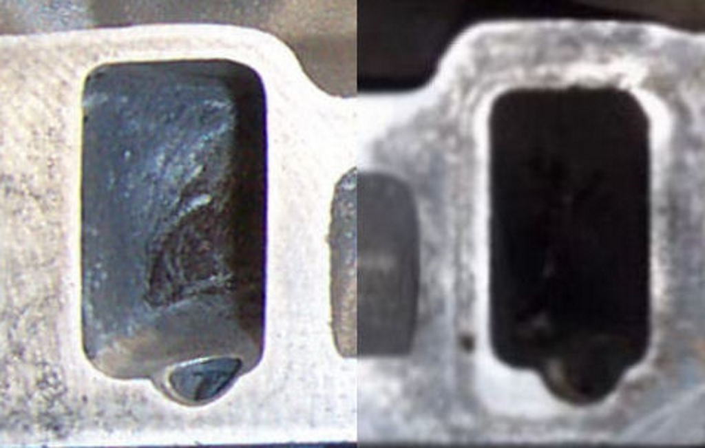

On my Explorer intake and my 70mm throttle body/EGR spacer I had to port it to get it to the correct 70mm size without restriction. It might be close to 70mm but its definitely not 70mm. I ported it straight in as far as I could reach. Combined with some custom sculpting to get rid of the a/c hose mount on the right front corner of the upper intake I continued the ribs all the way to the front. I think it looks good too. I also had Tmoss port the lower to my TFS heads. Throw on some paint and the stock 5.0 HO plate and it looks stock.
Here are pics of my ports Tmoss Explorer left and stock GT right. While not 1 to 1 I tried to overlay them to show the port size differences on the lowers. I don't have any pics of my throttle body opening to show.
