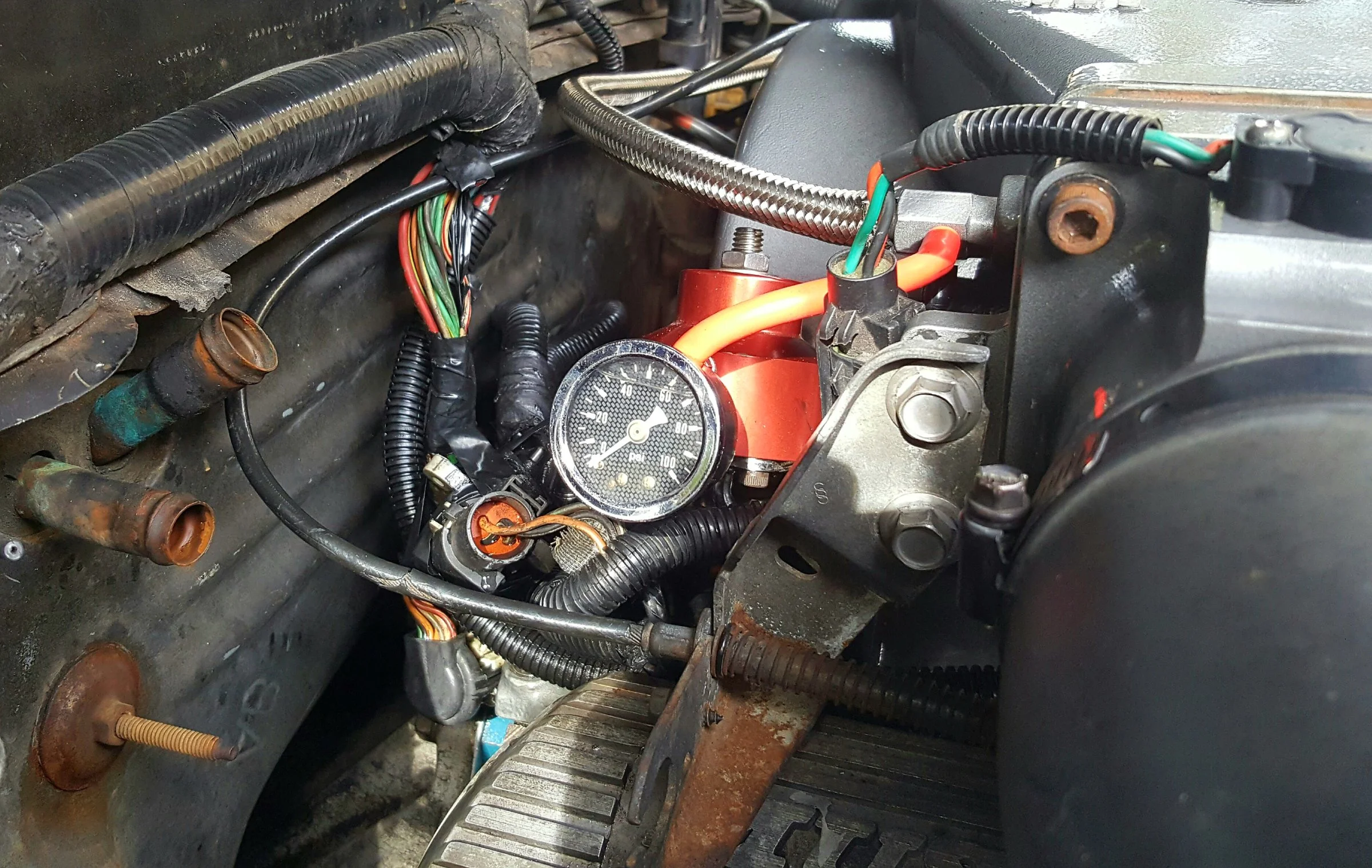

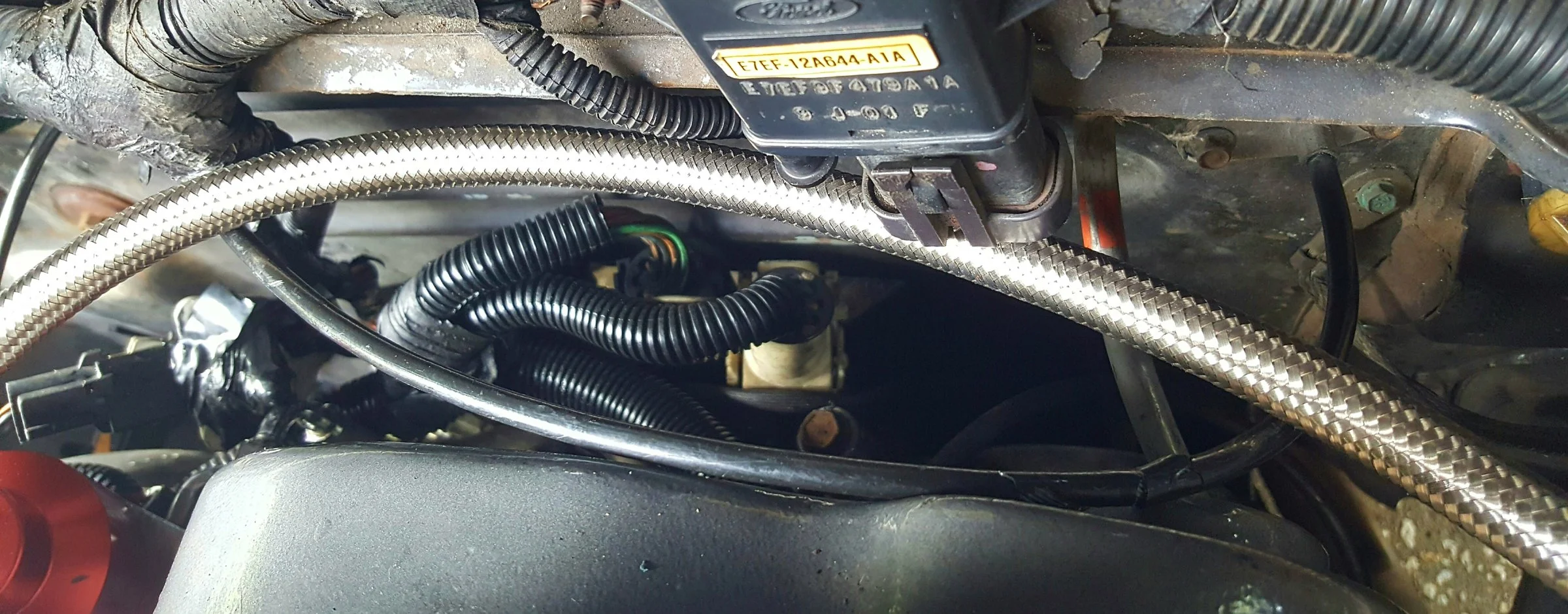

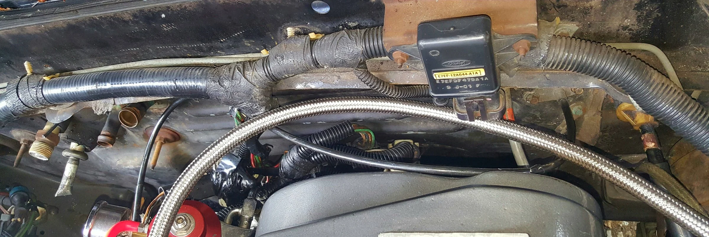

Few pics of where it binds...

Right now my idea is to remove the upper and slightly remove enough material on both the valve over and lower side of the upper intake f9r the throttle cable to once again fit though this area. It wouldn't be visible at all which is a plus. But it's a last resort. Shortening the cable if possible seems like a better way to go...
I don't see the problem. That cable would move just as freely bent in the "S" shape that it's in, or in a straight line.
It's a teflon lined steel cable sliding in a steel coil overwrap covered in rubber. The only reason it should be hanging is because there is some kink at the linkage, or that inner cable is frayed and hanging somehow....otherwise you could coil that thing into a complete 360 and it would still move freely.
Reactions: General karthief
I have the same intake on my car and noticed the same thing at first I just moved my cable around a little and no more problems I am also running the egr delete I only have a 3/8 spacer
The tb or end of the cable is probably hanging on the valve cover or associated stuff jammed in there. I had that problem and had to move a harness.
