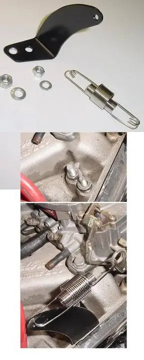

I had the same problem. I bought a dual spring setup and built a bracket:
