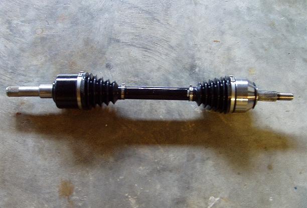

No, the 89-97 thunderbirds have IRS, and same axles as the 99 Cobra.
