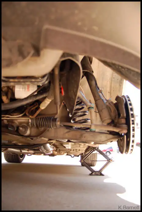

ok since i've installed the longtubes on my car ive had a nice little tick whenever the wheel is turned to the right and im rolling OR during heavy braking. the noise is Vehicle speed dependent and only seems to occur whenever the front left is loaded.

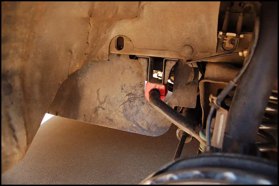

i thought that it might be one of the dust shield since im running 03 cobra brakes so i jammed all of those out of the way more... no change...
figured it was the bracket that holds the ABS sensor cable... jammed that all the way against the strut with no change.
last night i figured, maybe its my stainless brake line****ting a wheel weight, well with the wheel turned right there is about 5" of clearance lol.
my only guess's are a wheel bearing/hub or something to do with the rotor...
ive had a wheel bearing go out on my 86 Fiero GT before and it was more of a chirp that would get louder with more load, this sounds like something is hitting the wheel and will even do it in a parkinglot at idle in 1st gear with my 4.10's
what else is there to hit under there?
