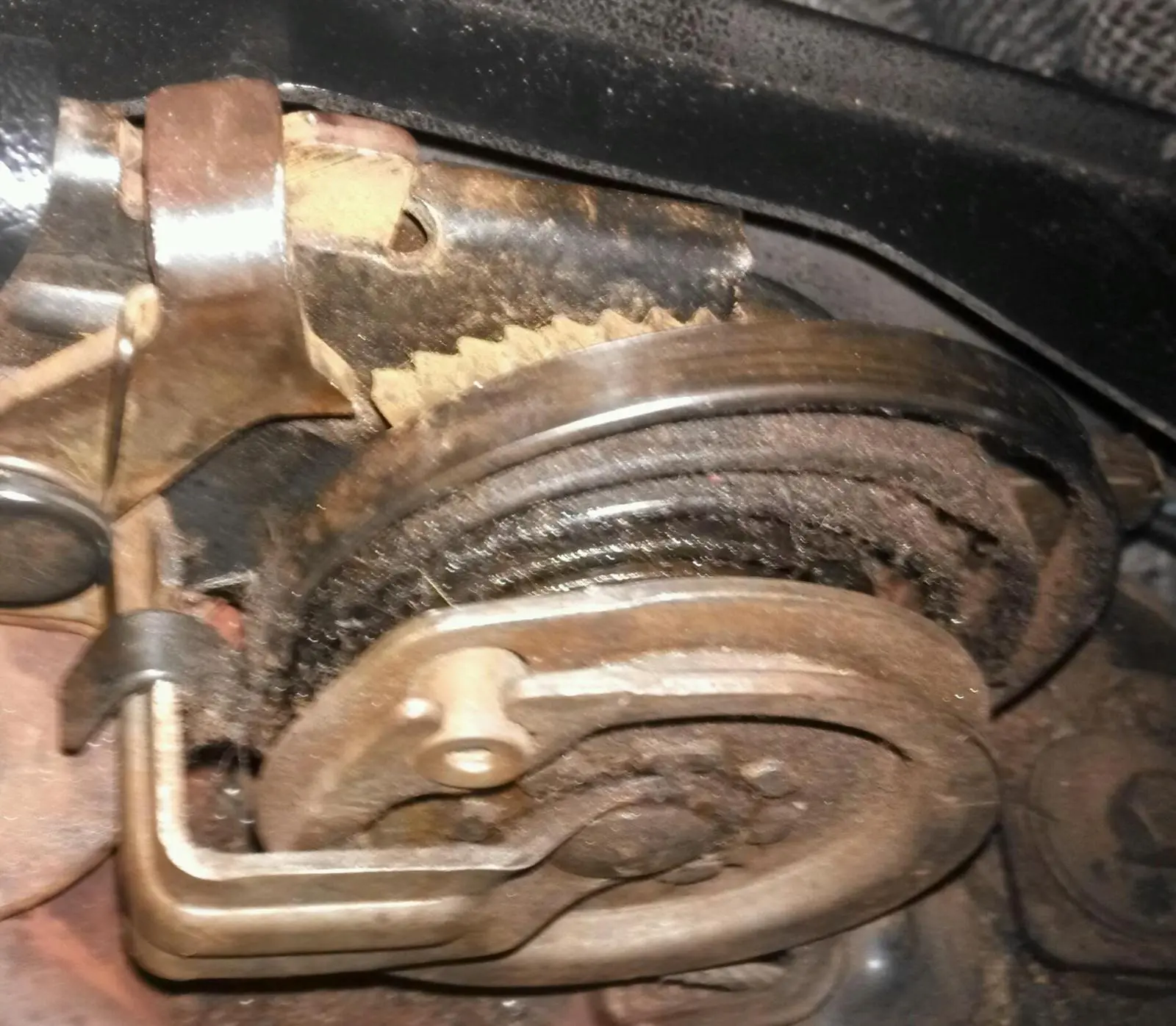

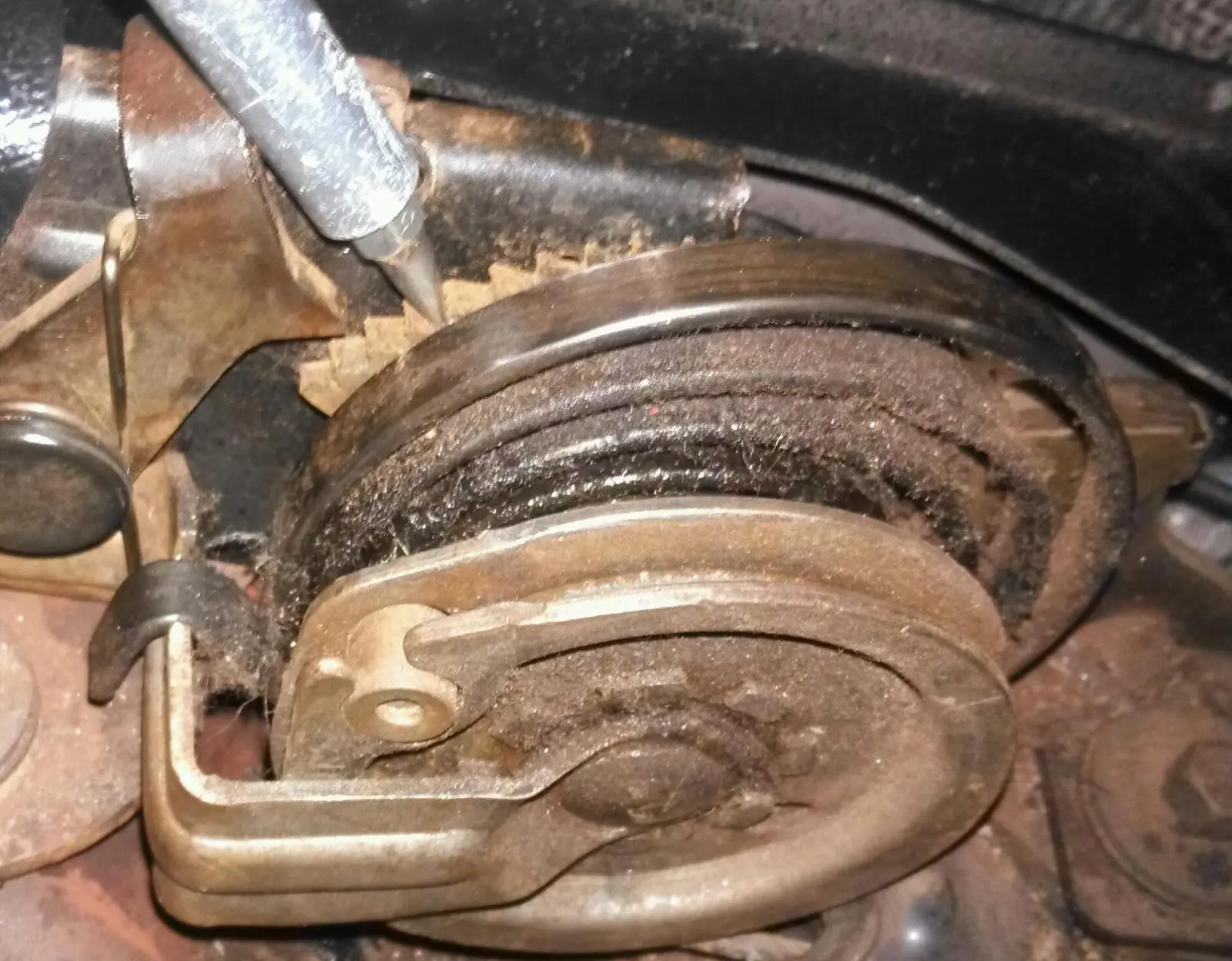

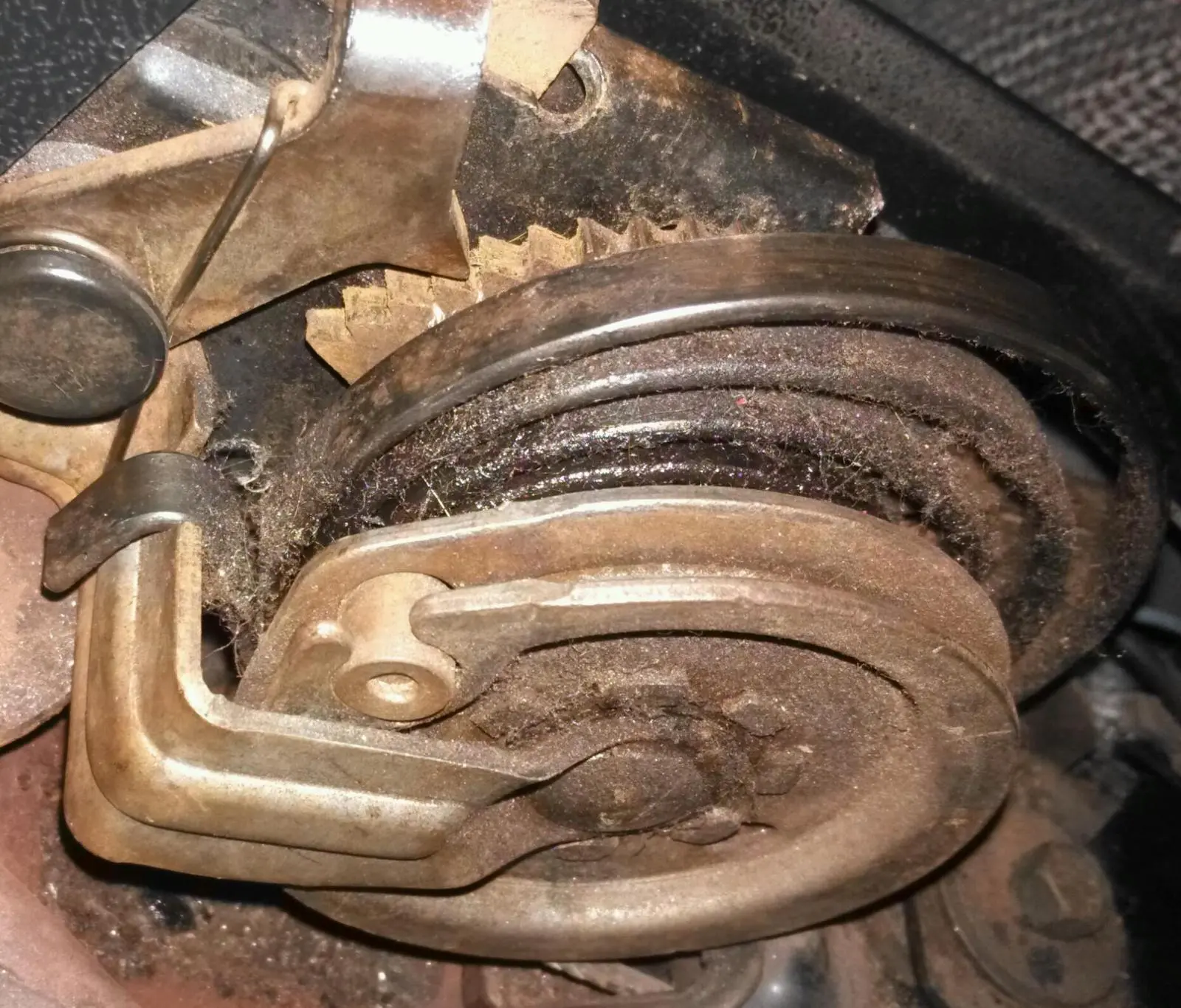

So I got it fixed, ....turns out the cable was not broken but the pully teeth had turned too far forward. So I used a screwdriver to ratchet it backwards. Here are the pics of what I did. It was turned all the way forward where I could not even see the cable, i just thought it broke.
I'm just glad I can return that part too!! I thought I'd look underneath to see if the cable was hanging and it looked connected, so I dove into the "remove console lid inspection" and seen it was still on but loose. If it ever seems to get loose again I believe I can just reach it with a screwdriver again with the lid on and lever it from the valley.
