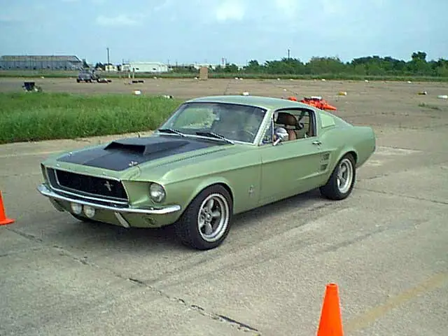

620 lb coils in the front with shelby drop. rear is 4 1/2 leaf standard eye.
