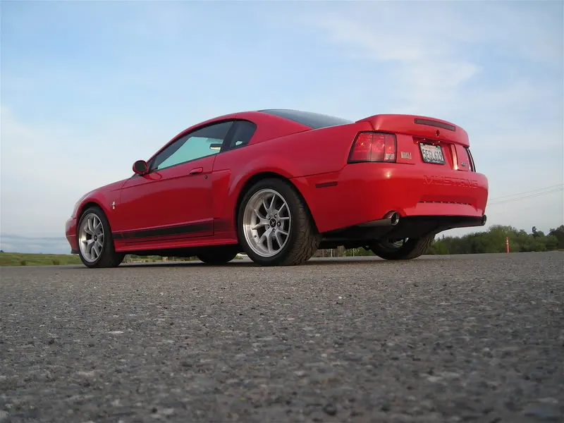

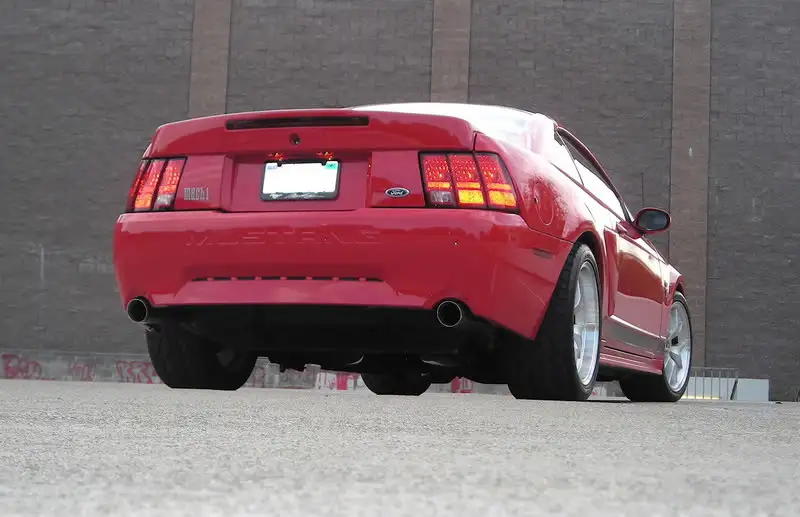

I had H&R supersports (1.8 inch drop), & I never bottomed out at all. I now have coilovers in the front & H&R's with adjustable lca's in the rear, & my car is lowered at least 2 1/4 inches all the way around, & still no bottoming out. I figured if Im gonna lower my car, I want it to look lowered. C springs dont drop u very much, nor do BBK's, & as long as you get some bilsteins, u wont have to worry about bottoming out.

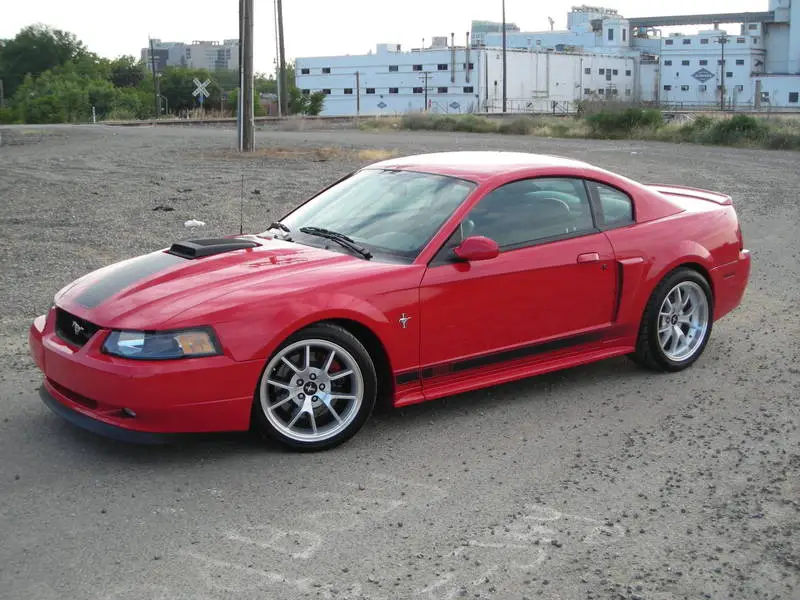

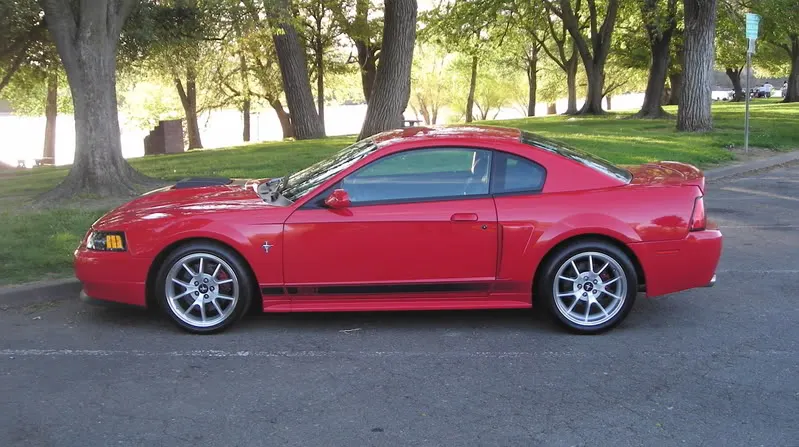

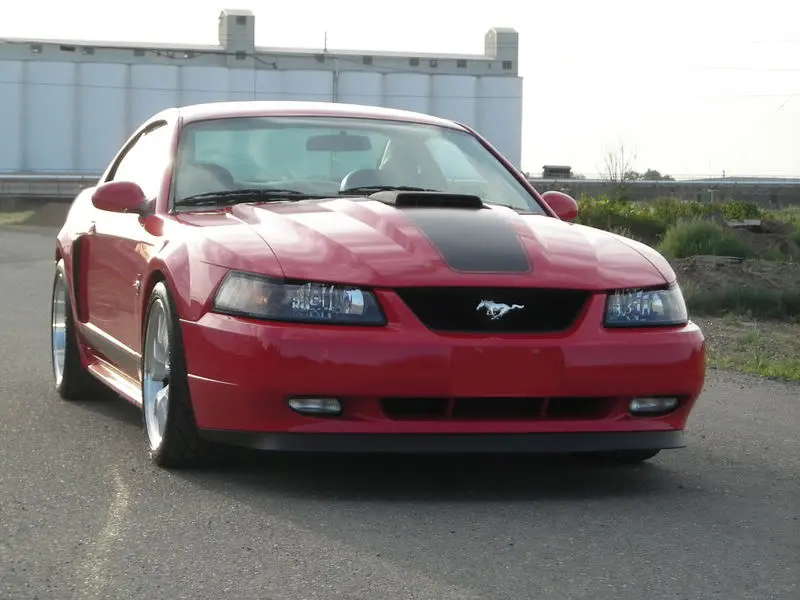

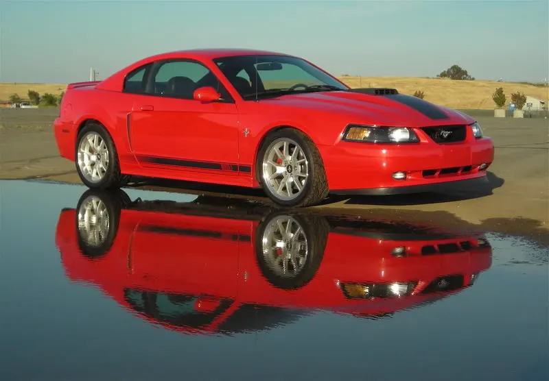

Heres a few pics of my car lowered about 2 1/4 inches with coilovers in front...
Thanks:D U should get the H&R's & your drop will look like the one in the 1st 2 pics. I dont think I ever bottomed out once. My only experience lowering my car only 1 1/2 inches, like the BBKs do, I was extremely dissapointed, & ended up buying springs again. & C springs will barely lower the car @ all, & they rake it out alot. Good luck
