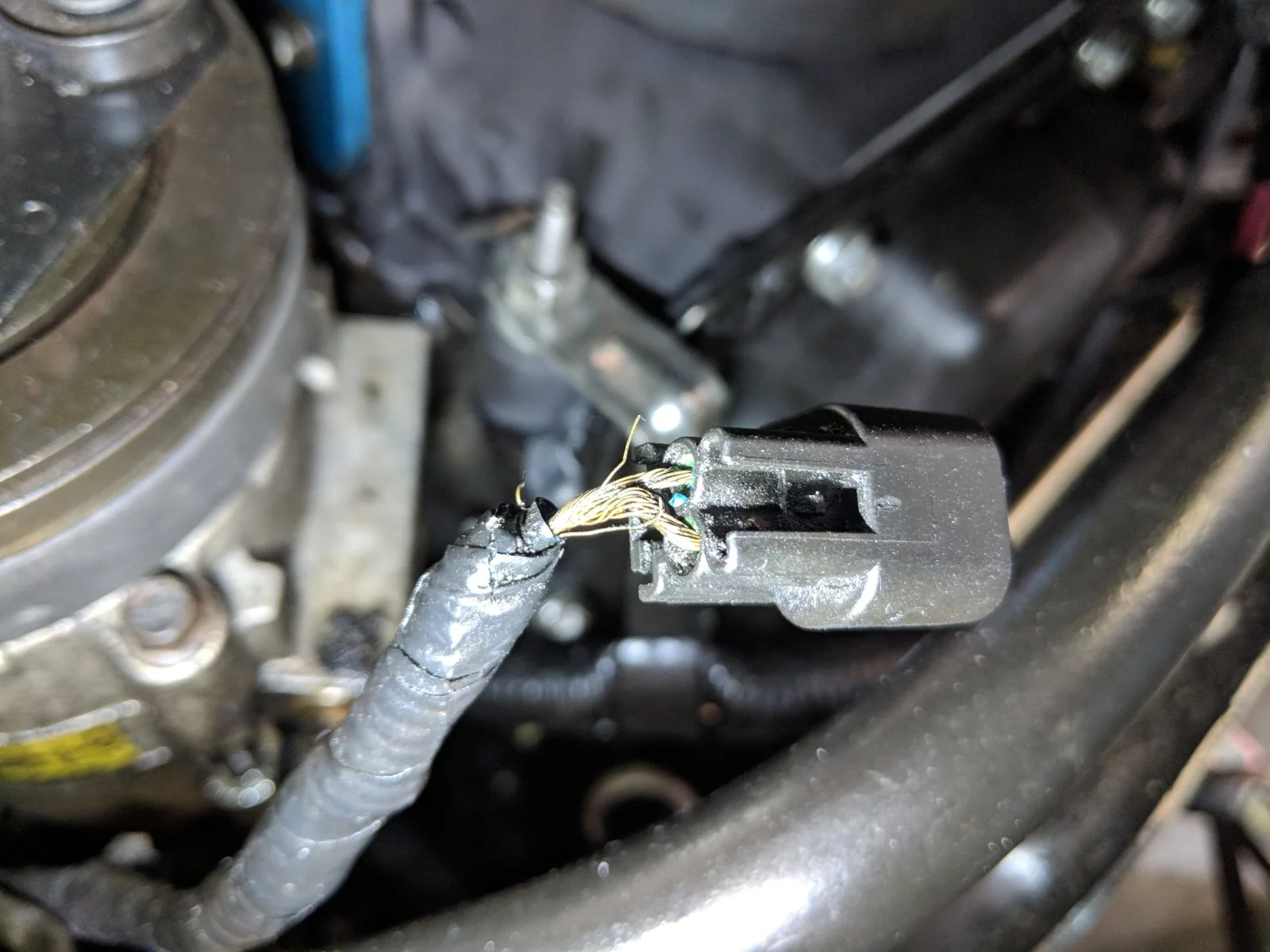

The engine back together but when I crank it, it will not start. I noticed my RPM gauge isn't moving and I hooked up a scanner and it shows zero rpms the whole time. I checked for spark and I don't have any. I'm stumped right now. I double-checked the crank and cam position sensors. Before the rebuild I had RPM signal.
I did. When I first took it apart I was like what the hell is this thing. But I found the issue. The wiring harness for the crank position sensor was twisted and shorted out. I couldn't see this because it was covered by that wire tubing. I fixed it and it fired right up! Revs strong too.

The picture is what was causing my engine to not start and not have an RPM signal. Once I fixed the connector, it fired right up.
