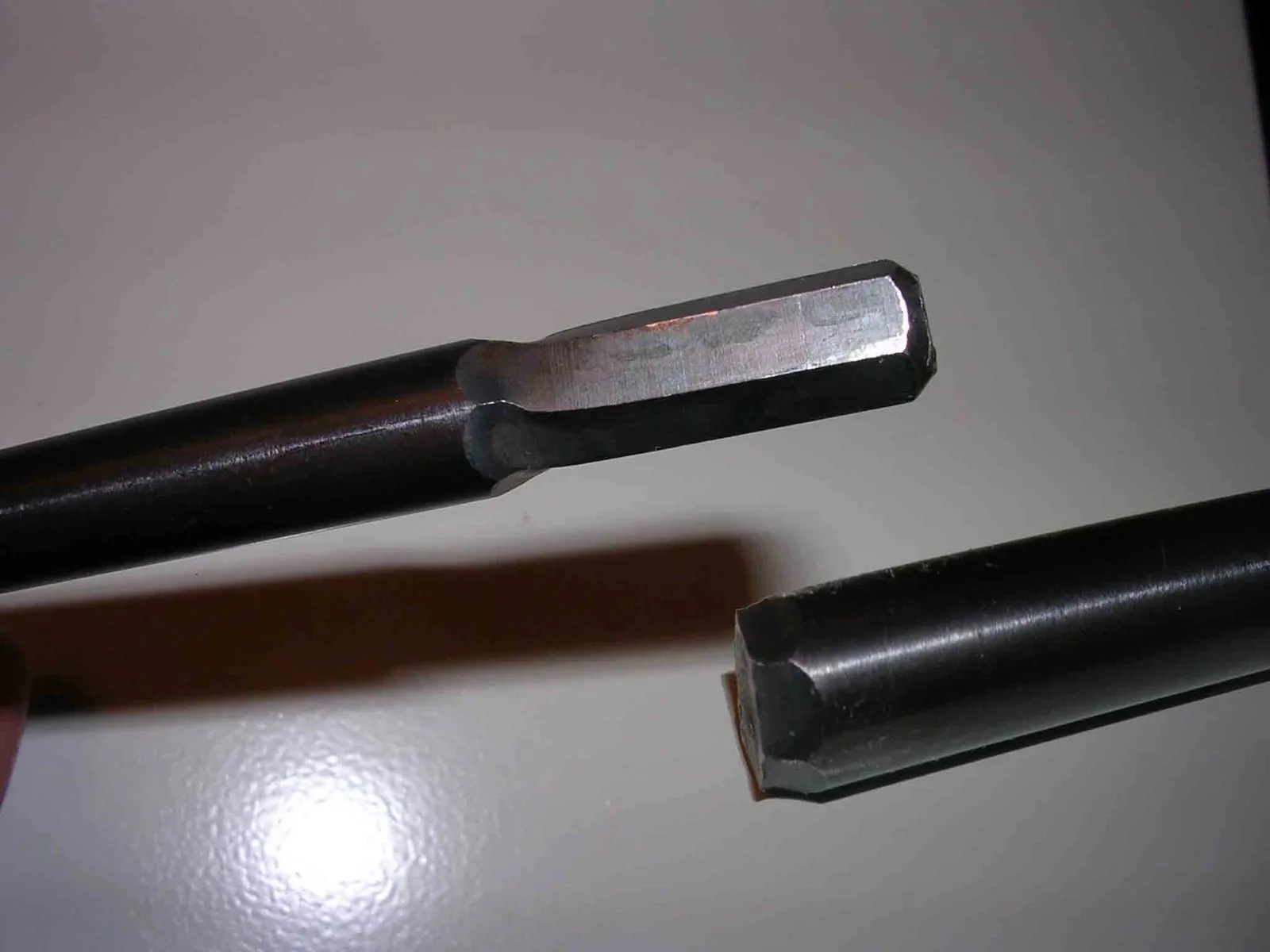

Lesson learned: DONT BUY A MILODON OIL PUMP DRIVESHAFT!
http://forums.stangnet.com/attachment.php?attachmentid=36359&stc=1
The Ford Racing one's aren't any better. I bent one trying to get the distributor seated in a 5.0.
