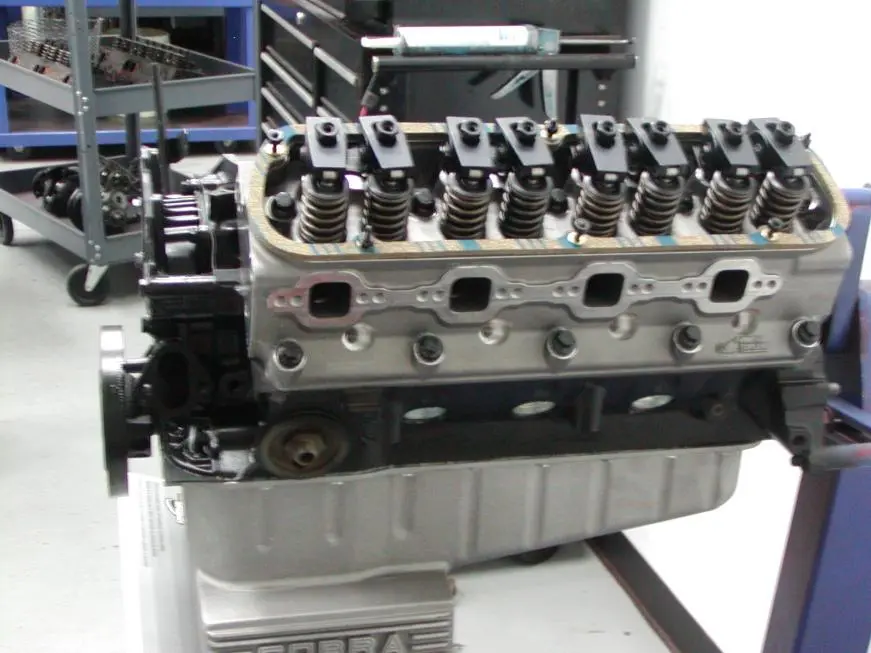

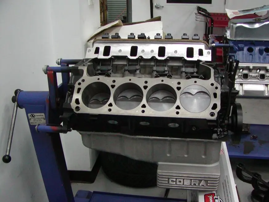

I hear what you guys are saying but the balancer is a brand new reproduction item from Virginia classic mustang. Take a look at the attached pics of the motor. The first shows the #1 at TDC and the second, although not clear, shows the timing pointer at TDC on the balancer. Is it possible that the distributor was installed one tooth off. Would this create a reading of 30 degrees advance when running well and not running at all at 12 degrees advance as indicated on the balancer?

Being a tooth off doesn't affect the timing readings. It does affect the amount if travel in the swing of the vacuum advance pod. The difference in the pointer and the timing marks are due to the marks being in the wrong position on the balancer. Get some "Timing Tape" and correct it.
