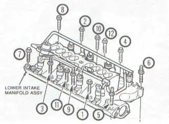

proper torque sequence for the lower intake..
torque in 3 steps
Step 1 torque all bolts in sequence to 8 ft.lbs.
Step 2 torque all bolts in sequence to 16 ft. lbs.
Step 3 torque all bolts in sequence to 23-25 ft. lbs.
