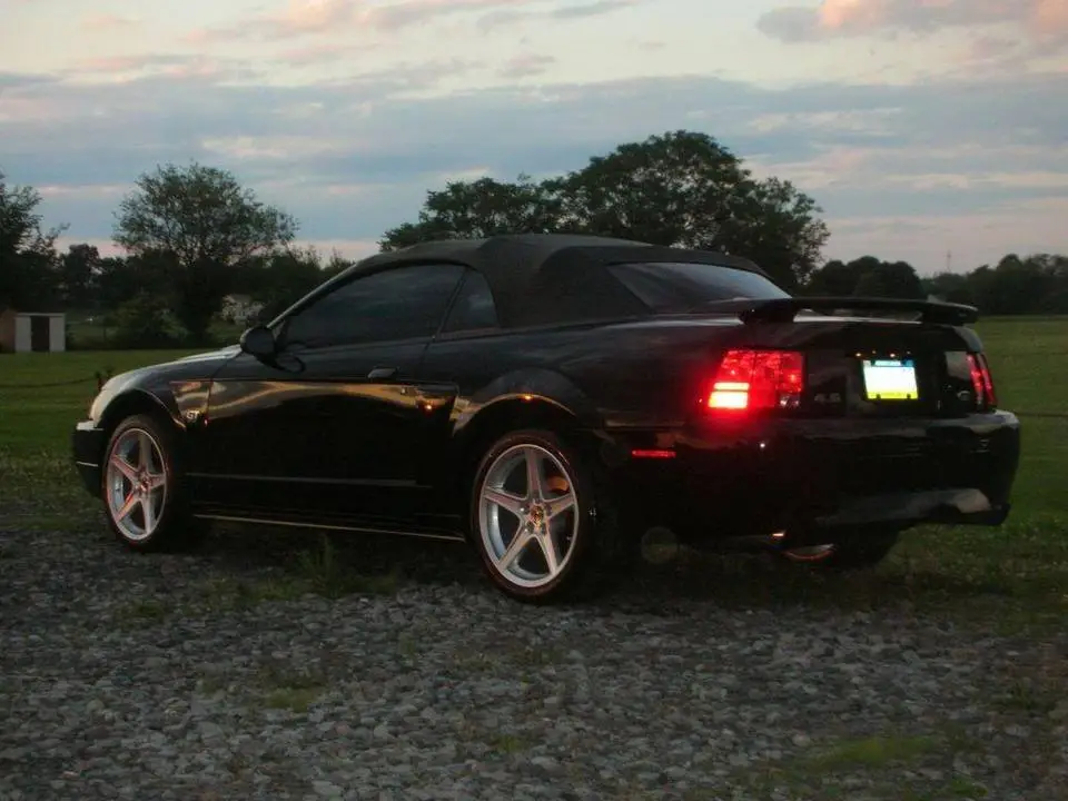

it is not that easy... granted you have a convertible so its easier that the coupes.. you have to lay the tint out on the outer part of the windows and trim to fit...use a bondo spreader wraped in a paper towel and smooth out the tint. if there are runs in the tint you need to heat them with a heat gun while rubbing them out with the spreader. once its smoothed out remove the clear plastic and spray it down with soapy water. spray the other side of the window with the soapy water and install the tint. work out runs again and you can use the heat if you need to. be sure not to get the heat to close to the tint or hold it there too long you may melt it. i would not go darker than 15% because you will probably get pulled over. good luck and here is a pic of mine with 15%.

ok i love the look of yours, 15% it is.. any darker i don't think it would look as good
