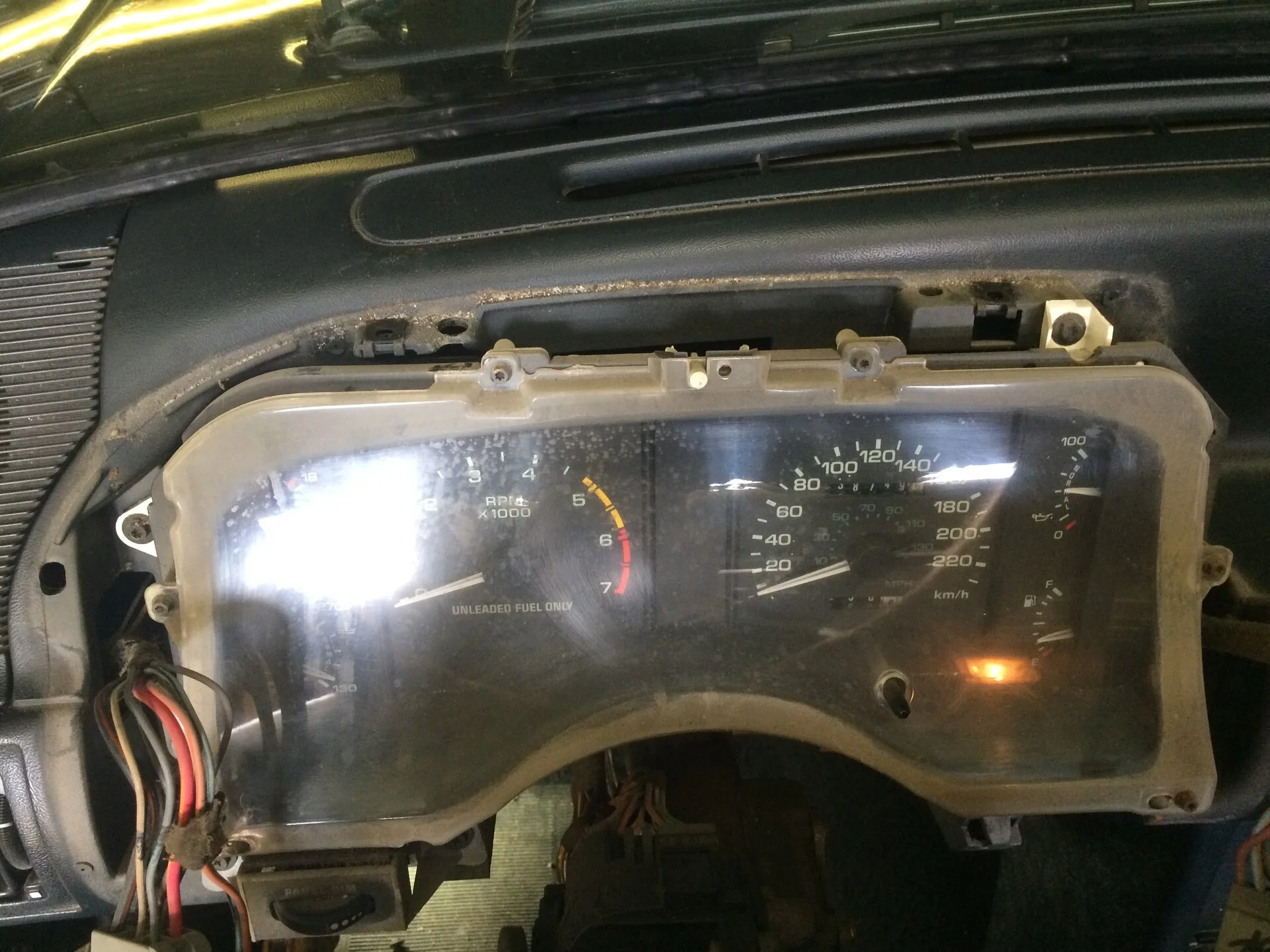

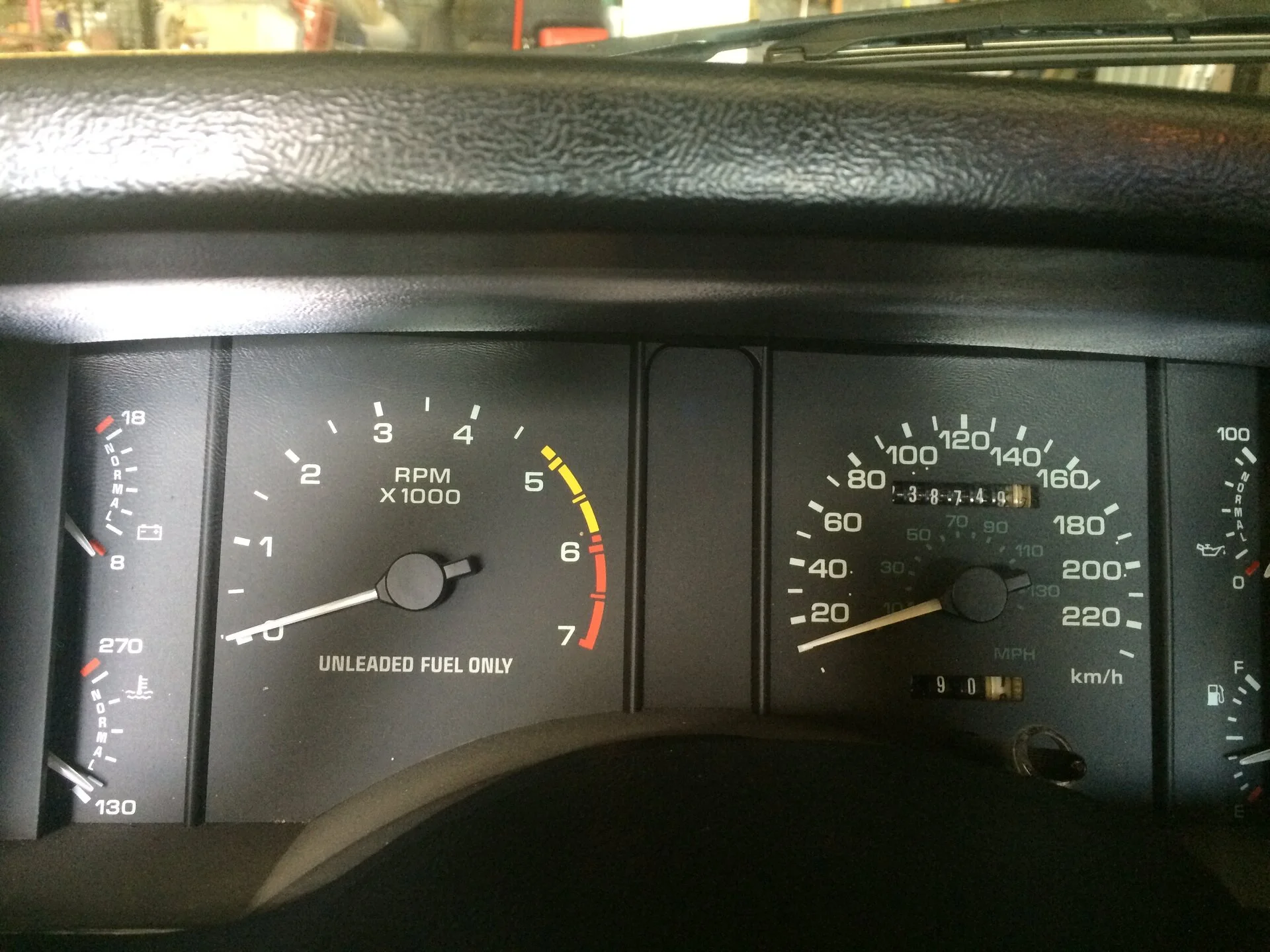

Before and after cleaning and polishing the gauge cover on my 90GT. I just used a headlight polishing pad on a drill and some Meguiar's Ultimate Compound (any brand name liquid rubbing compound should work). Go over the whole lens a couple times buffing clean between each until there is no streaks or issues.
