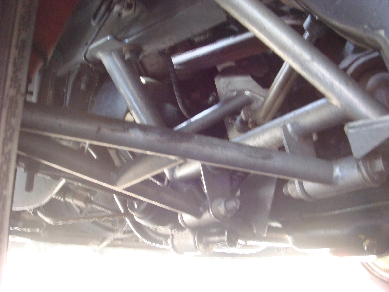

I've got a UPR K Member, Control Arm, and Coilover set up on the front of the car. 18 x 9 Cobra R wheels, and 255/35/18 tires on front, and 295/35/18 on back. There's also a lowering spring and KYB Strut on the rear of the car, but I don't think I'm getting any trouble from those two. Up front, things are getting a little screwy.
I bought the car in April of 2011 with all of these mods on it and the owner had installed them about a year prior to my purchase. Everything was pretty good and checked out my own inspection when I purchased it, and it was on the cheap side, so in a pinch, I settled with the owner on a price for about a grand less than he was asking, and off I happily drove off into the sunset with my new ride. After the honeymoon period ended, my closer inspection noted a few unsightly repairs on the front fenders and bumpers, and also the wires for a removed subwoofer the owner cut off and hid. It's always had a little bit of squeak on compression over bumps, and I've always assumed it was just the aftermarket suspension and bushings and what not. The car has always loved to turn in to initiate a corner. Sometimes it's made me question the oddly not congruent/symmetrical c/c settings at the shock towers. The car has also had a little slop in the steering wheel and needs a good 20-25 degrees of correction towards uphill when traveling straight, over lateral slopes. Overall though, a flat car for not having a sway bar upgrade, and good front to back stability as well making me thing that the springs and compression are sufficient for grip improvements. I don't really mind the ride quality issues, never the less.
Well, as of the past few months, at some point a lug nut snapped off a lug of the drivers front, and the squeaks or loud creaks can be relentless on some days and non-existent on others. I've also noticed that I'm getting a crack developing in the drivers shock tower, under the outer-forward bolt hole. under the c/c plate. On top of all that, the car can sometimes feel a bit squirrely at first being driven after having sat a day or two and I've got some nasty front tire wear on the insides, that makes me believe I've either got way too much camber (though it looks subtle to me) or a toe/alignment issue. The car is being daily driven in Los Angeles, and I've heard that's probably about the worst thing next to trying a truck trail or war zone for a car with coilovers, without Strut tower braces or Subframe connectors.
Honestly, I love driving the car, but this ish is getting a little weird, and it really makes me worry. I know I need to get that lug replaced, but I'm worried with the stress it's been under, maybe I should just replace the whole hub assembly? The tire issue really sucks because I was on my way to the airport last tuesday and it was still dark o'clock as I was merging onto the 405 and as I was merging in and checking mirrors, I ran myself out of reaction time for a piece of shredded truck tire that I'm presuming is what is responsible for leaving a chunk of melted rubber in my wheel well and the inside of my passenger front tire being worn down to the threads, while the driver's inside is definitely heavily worn, but no threads yet. I guess I need to get it evaluated by an alignment shop to be sure? I need new rears too, as the diff is an open one and the right tire out back is showing threads. And does anyone know if it's possible go back to the stock style strut set up while still using the control arms and K member? What of the shock towers if the cracks are serious?

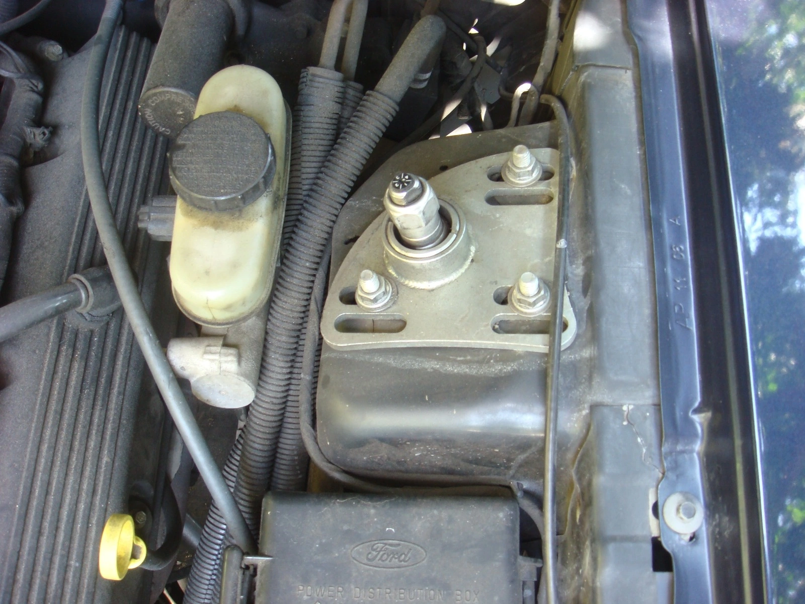

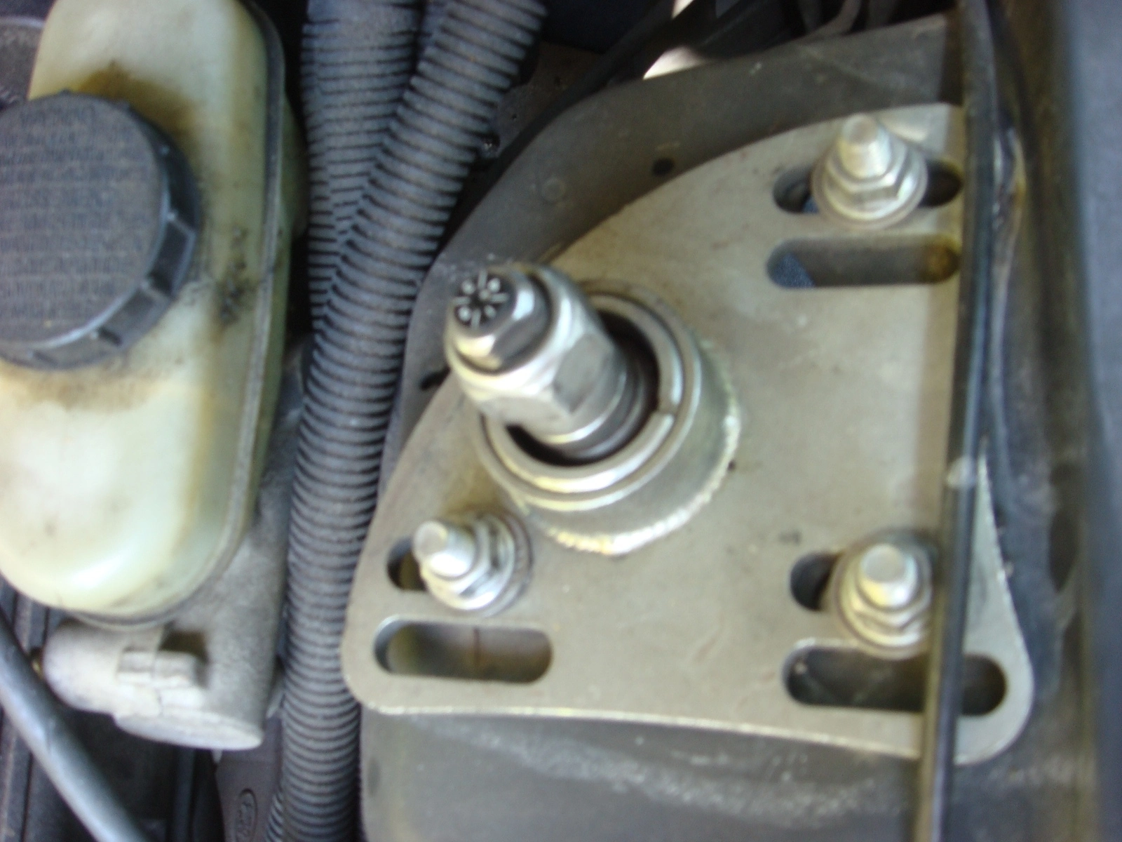

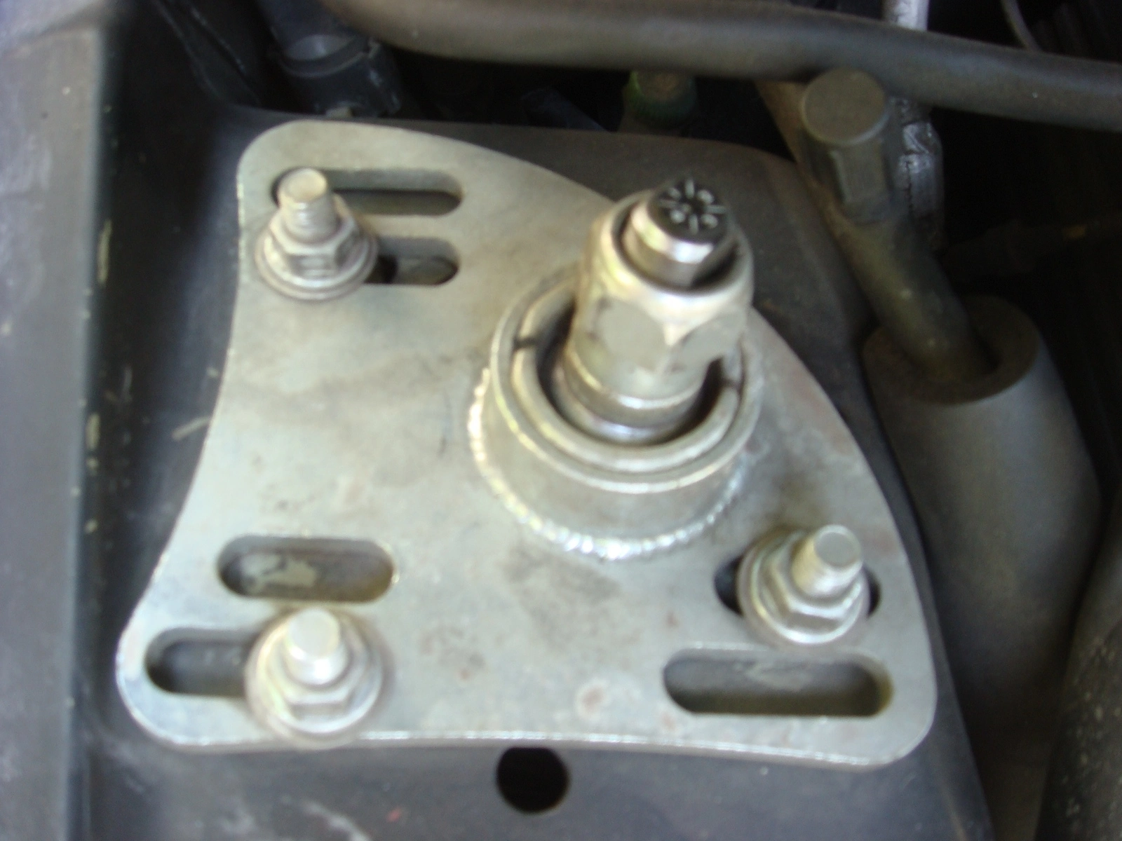

Drivers Side Strut Tower Crack (inside forward bolt actually)​
DSC01389.webp​
Another of the Crack​
DSC01390.webp​

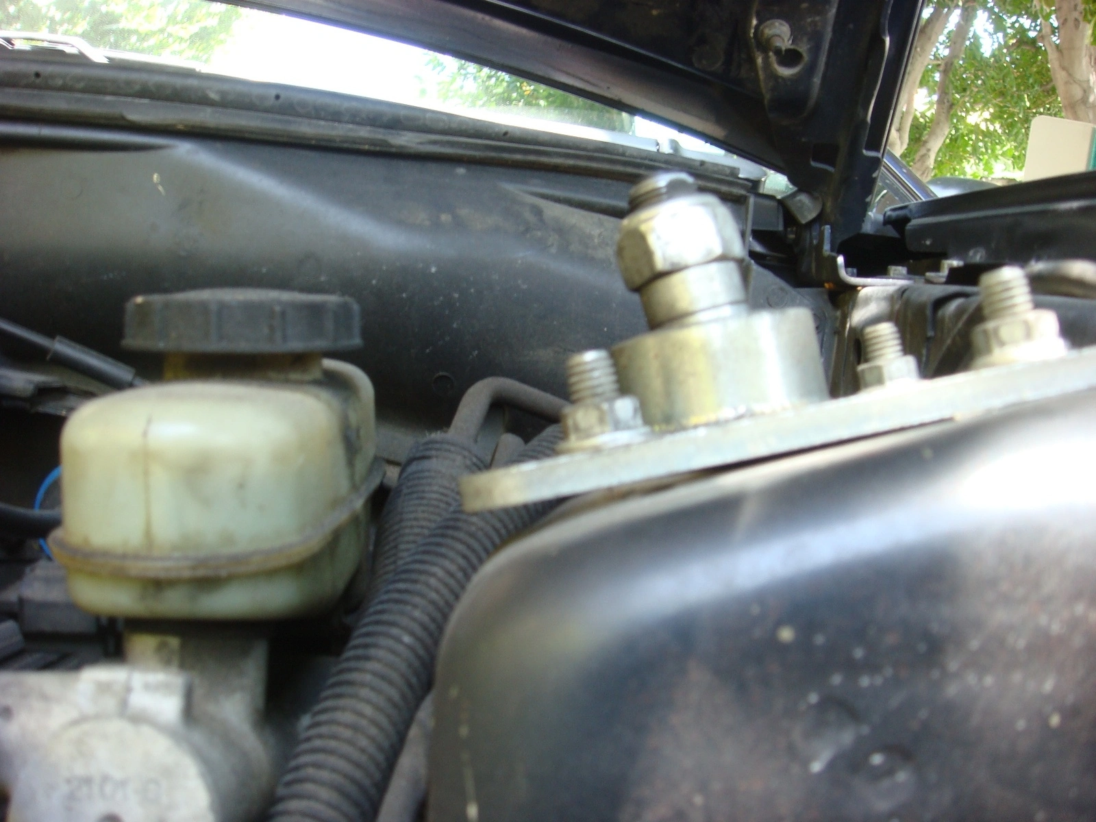

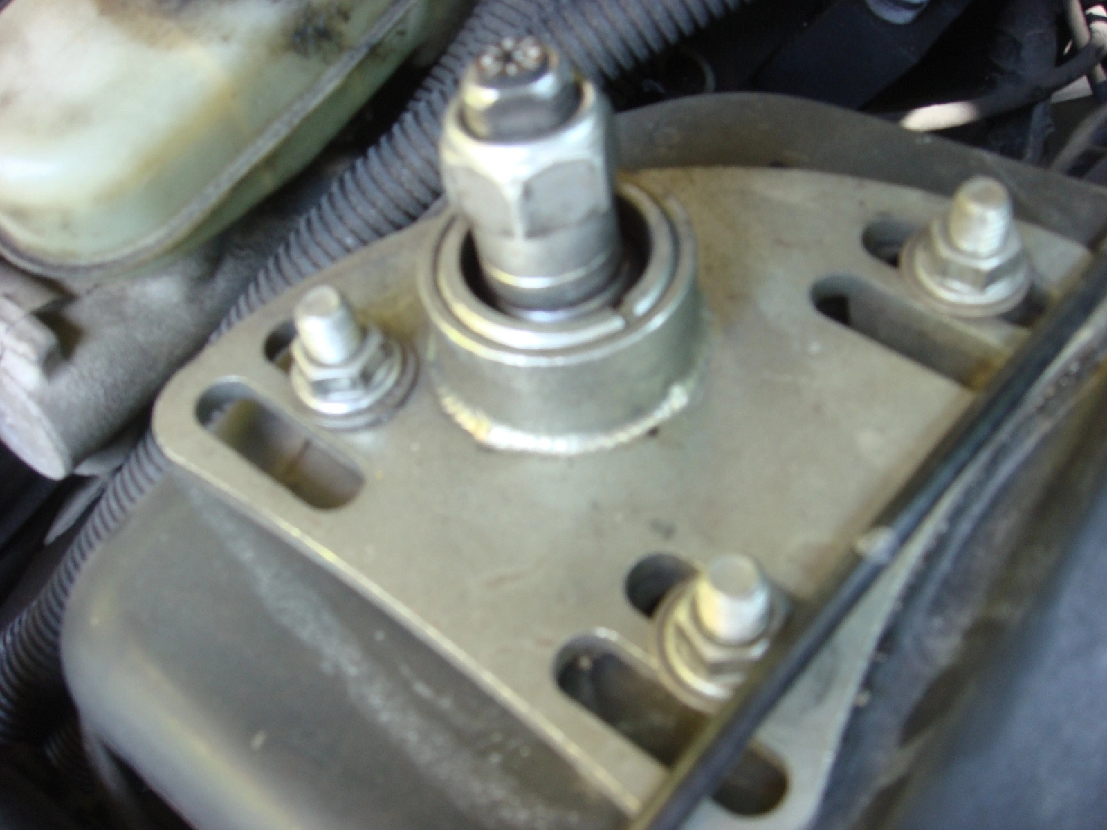

Horizontal View of Drivers Side Strut Tower from Front of car perspective​
DSC01391.webp​

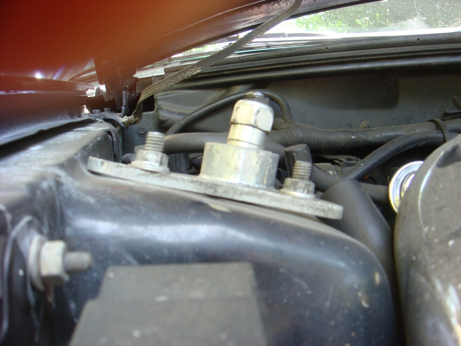

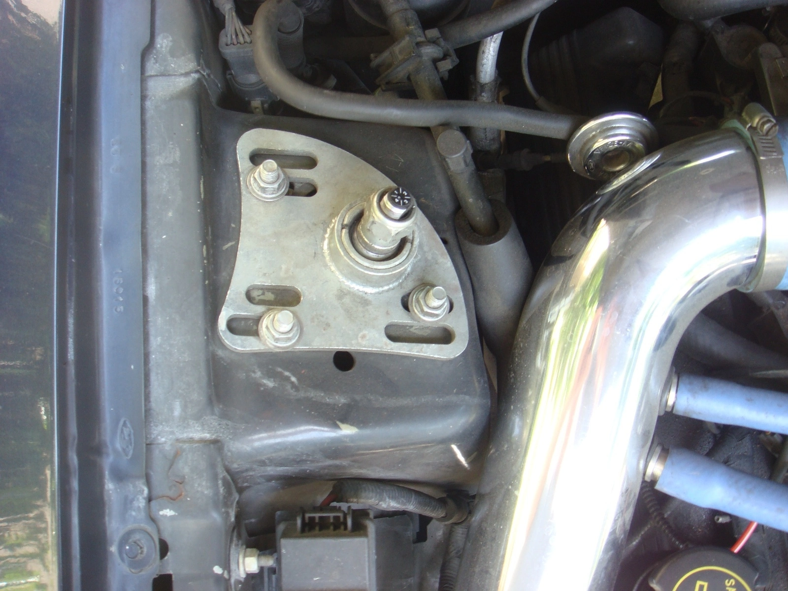

Passenger Side Strut Tower​
DSC01393.webp​
Horizontal View of Passenger Side Strut Tower from Front of car perspective​
DSC01394.webp​
Drivers Side C/C Plate Bolt arrangement​
DSC01395.webp​
Passenger Side C/C Plate Bolt arrangement​
DSC01396.webp​
First, get some different C/C plates. Get a set of MM plates that are a bit more adjustable than what you have. Also, I would be concerned on HOW those plates are installed. First, they are not uniform from side to side. That says that either they dorked up drilling the holes, or they are bent to hell from side to side. One of them is not even installed straight, one bolt in the front slot, one in the rear slot....if you look at that one, the front is pused over towards the fender more than the rear of the C/C plate.
Maybe those cracks are why Maximum Motorsports recomends only 4 bolt caster camber plates on coil over setups.
I wouldn't think there would be a problem just installing a new stud in the spindle as long as there isn't any play in the bearings.
To fix the cracks you need to have a hole drilled at the end of the crack to stop it from cracking more and then welded up.
New tires, new 4 bolt caster camber plates, a stud, an alignment, and a strut tower brace would fix you up fine.

Subframes are one of the best mods to these cars...that being said, I would take care of your front suspension first. Have a shop weld the cracks, install some good CC plates, and check other things in the front that are bothering you. Then get subframes...

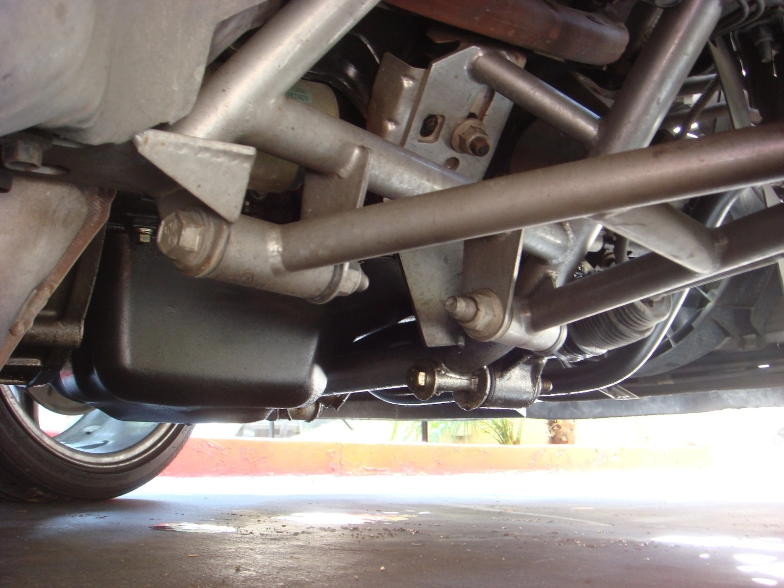

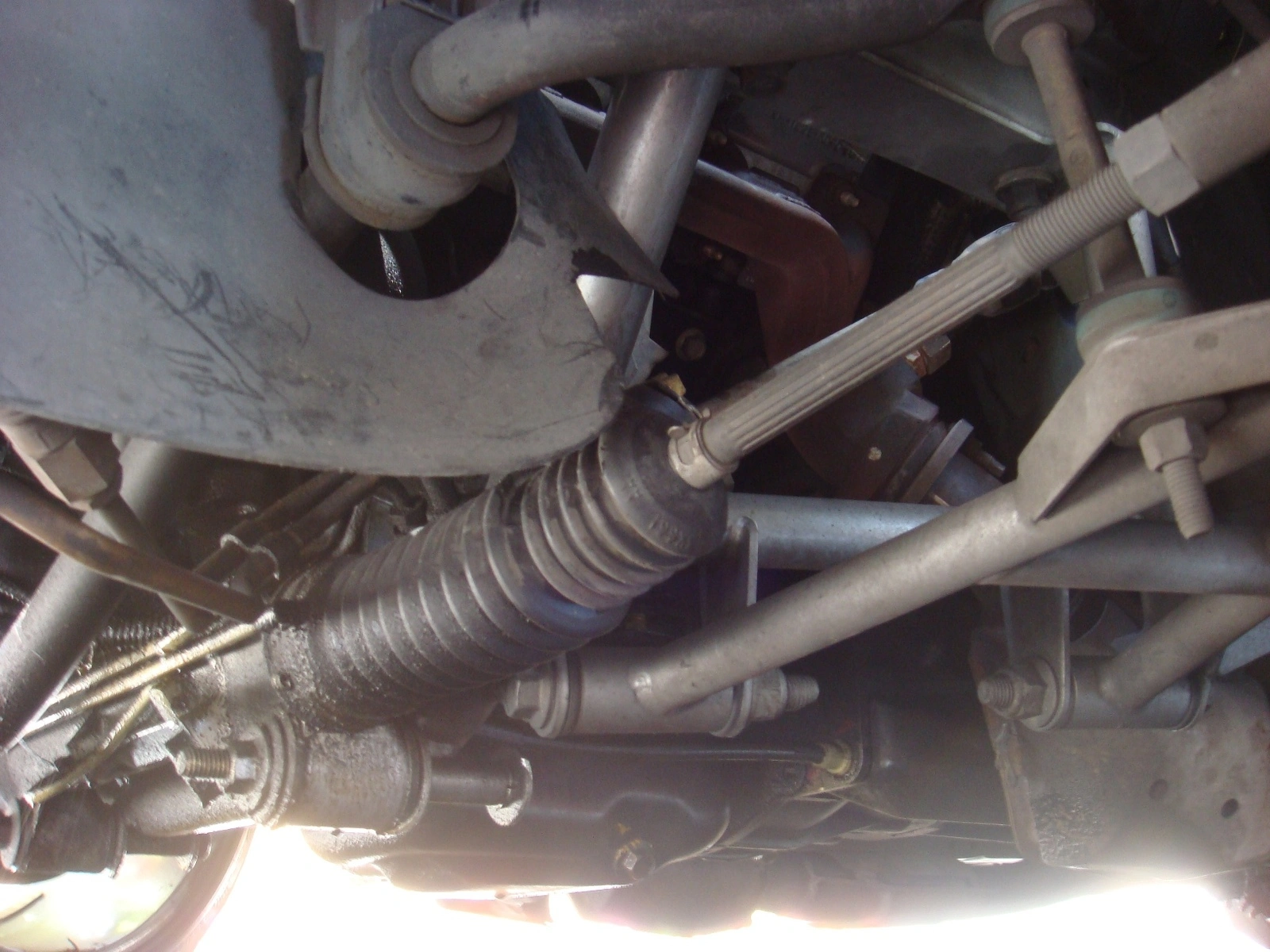

Tubular K members are not the easiest thing to install. You may want to have that looked at and make sure it is done right. I'd be willing to bet that's where your problems are starting. Half an inch off on one side will really throw everything off.

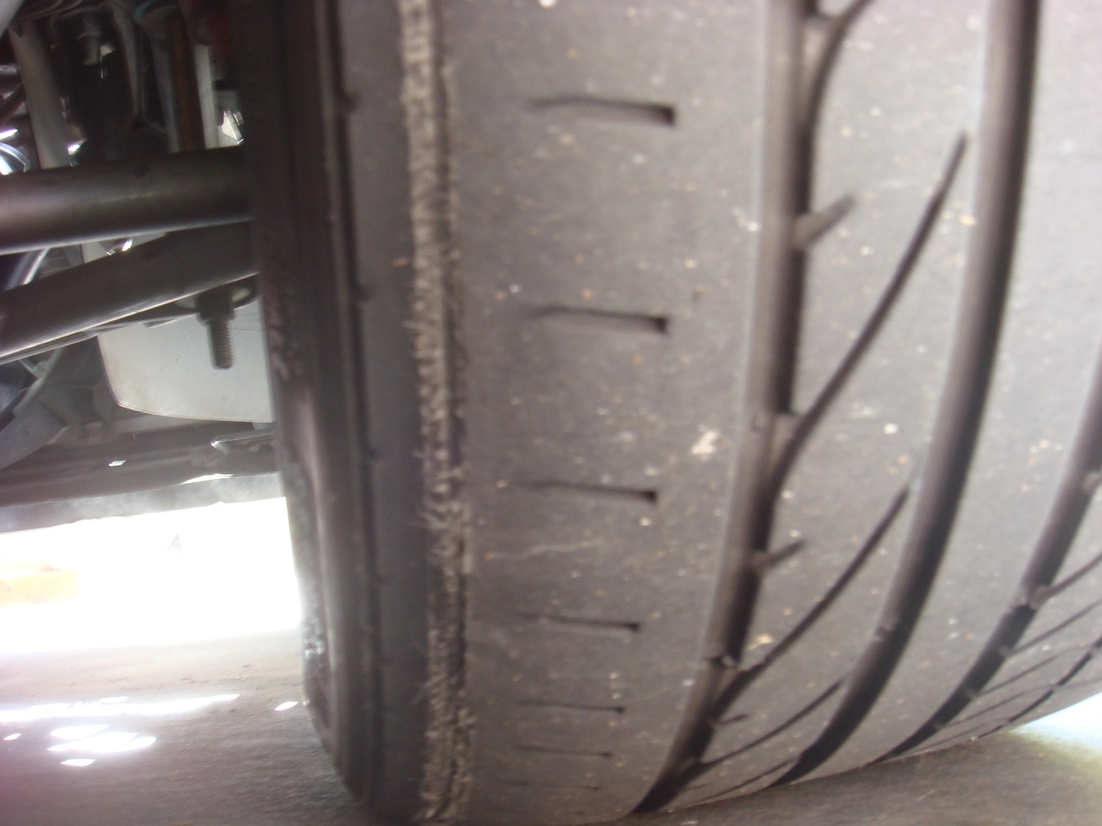

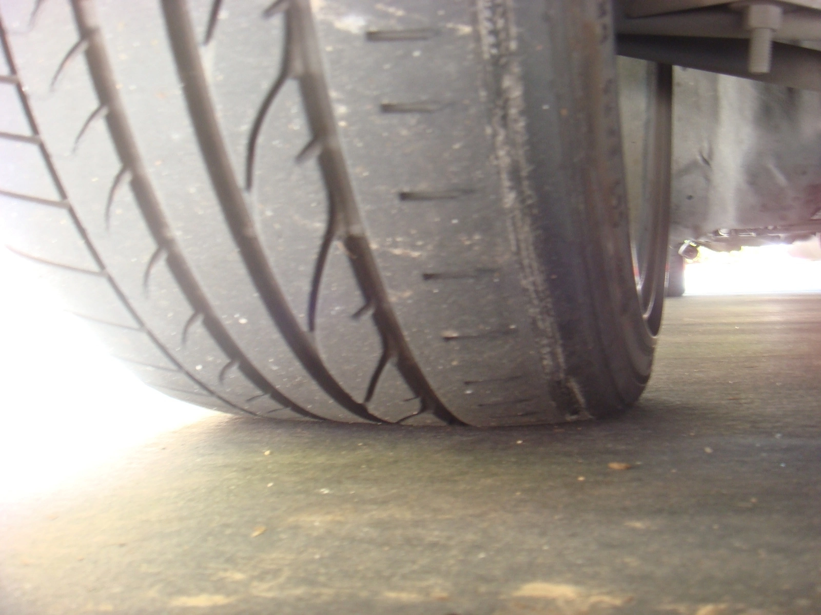

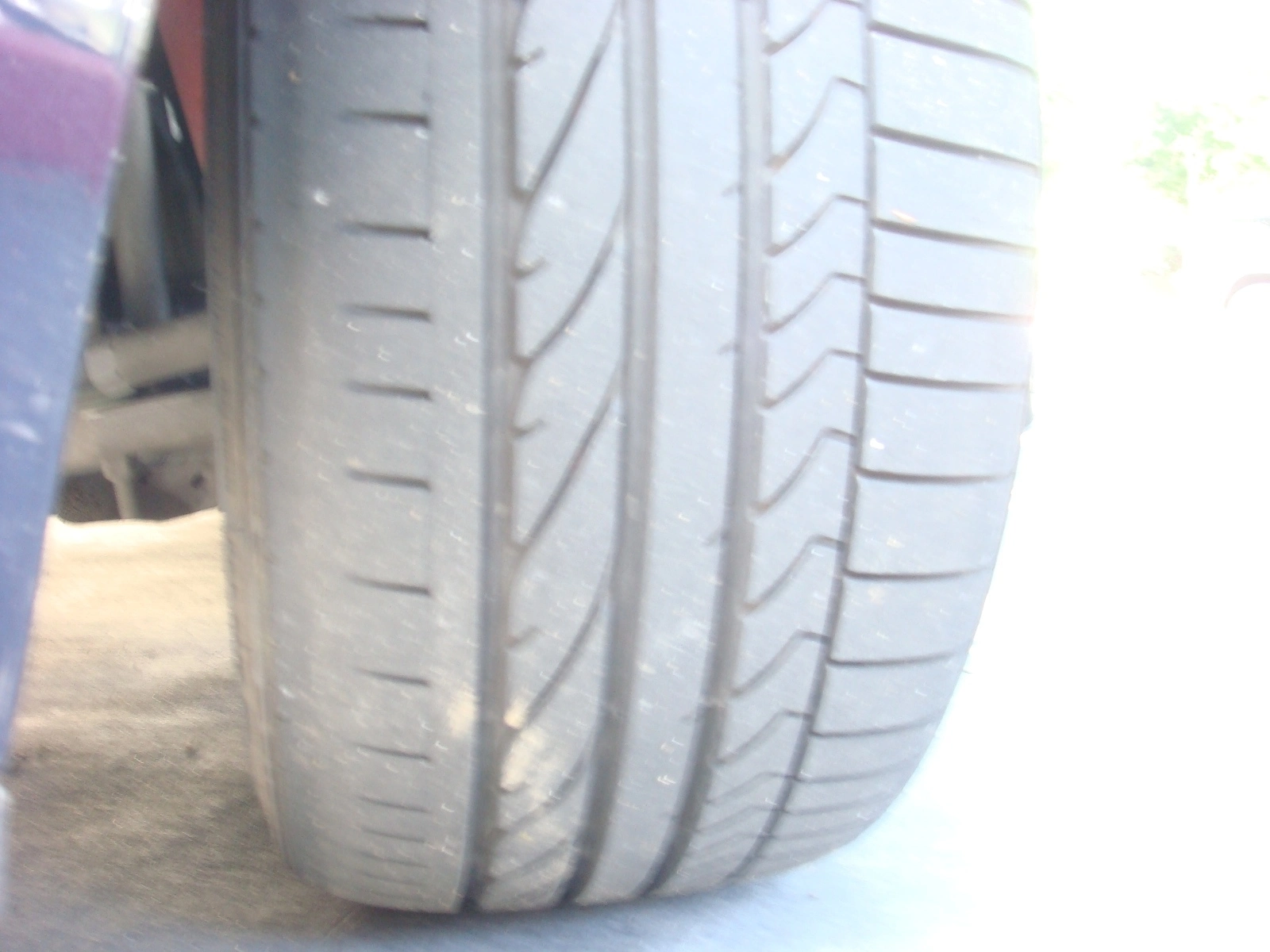

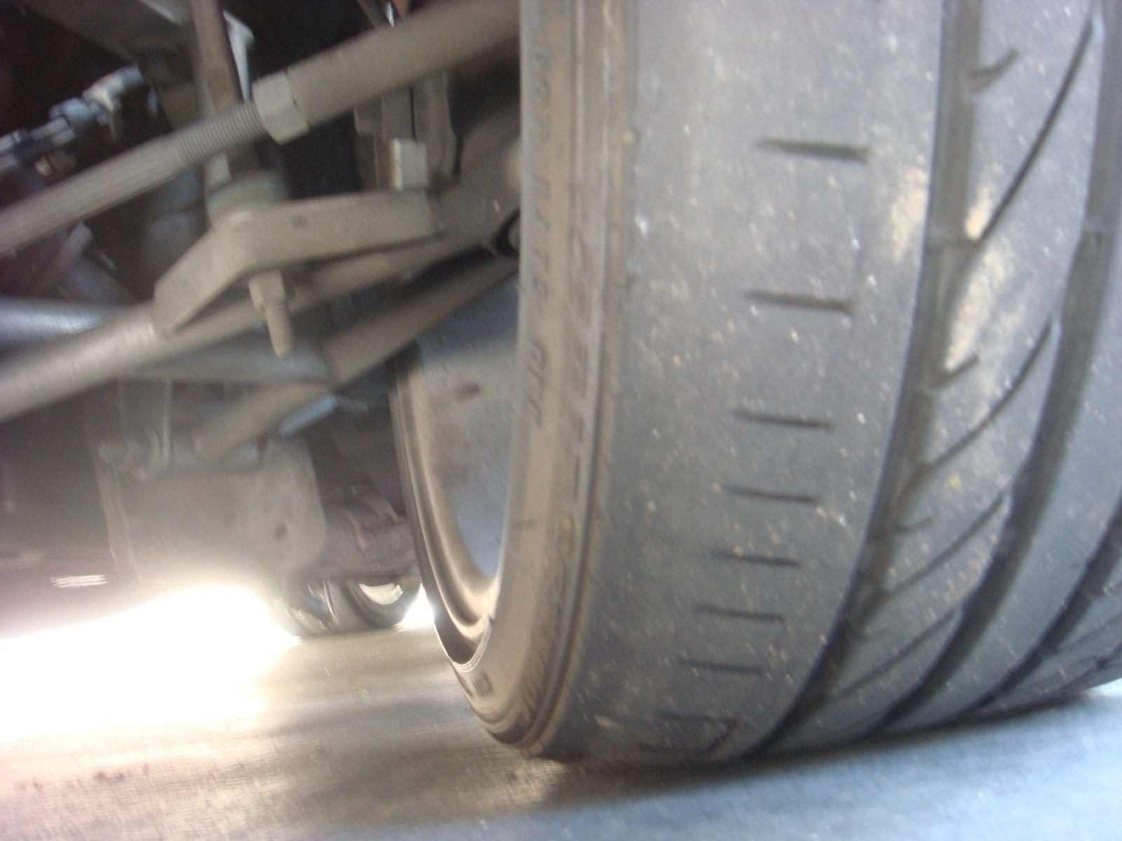

I don't think hitting the peice of rubber last week had anything to do with your tire being worn to the threads. Wear like that takes time to happen.
If you don't mind doing the work go on Maximum Motorsports web site and download thier instruction to install the k-member. On there you will find how to square the k-member in the car.

I showed up at my friends house one day and he was doing his tubular k-member with a stack of wood under the oil pan. Maybe not the greatest idea but it worked for him. Just be sure to use a peice of wood that covers the entire pan to better distribute the weight.

blocks of wood under the pan? Eek. This is a job that I'm a little afraid of taking on myself as I've never even attempted a wheel alignment, much less re-positioning a K member. I'm sure I could figure it out, but the car is my daily, and the longest I could afford the time to have it down is 2 days. I'd prefer to at least have the fender to fender engine support beam. I read through the MM instructions, briefly, and it definitely seems like a two man job for the uninitiated. One fully trained tech could probably handle it just fine, but I'm the only car guy in my group of friends, and it's obvious the last guy didn't get it right, though UPR is known to not provide these exact instructions with their K-members. Thankfully, I've got you guys to help supplement my lack of experience, which is always encouraging. Nothing like the pride of doing the job on your own, with the collective brain that is the internet. BTW, I would definitely want flat ground to do this, being as I have to plum bob some things, right? That right there is the hardest part. No one I know (even my bosses) has a garage or even smooth flat ground to work on. Doing this on a hill would probably be idiotic.
First of all, the cc-plates are installed incorrectly, and that's a problem. If the installer wasn't qualified to install the plates properly, is it even possible that the car was aligned properly? Not likely. That would explain the uneven tire wear and erratic handling.
That said, I've never seen a strut tower crack without having been damaged in an accident. The evidence of shotty fender and bumper repair pretty much verifies my suspicion. I'd have a reputable body shop inspect the front end for frame damage.
Chances are, your cc-plates would be fine if they were re-installed correctly. (note-in addition to the improper placement, they are also missing some spacers). UPR Products carry a Lifetime Guarantee, and we may be able to help you out despite the fact that these plates were installed incorrectly.
Incidentally, we do manufacture four-bolt plates like MM uses, but our 3-bolt plates work extremely well and do not crack strut towers. So unless you just want to spend more money on MM parts, you do have other options.
In summary, we are perfectly willing to help you sort this out if you'd like. You can reach UPR Products at 561.588.6630.
