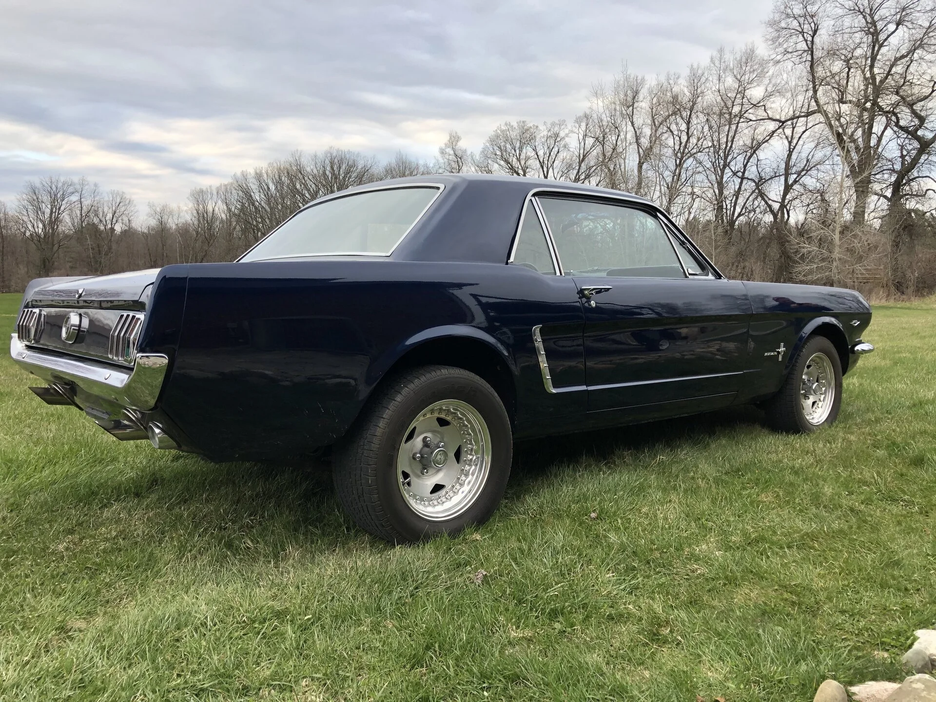

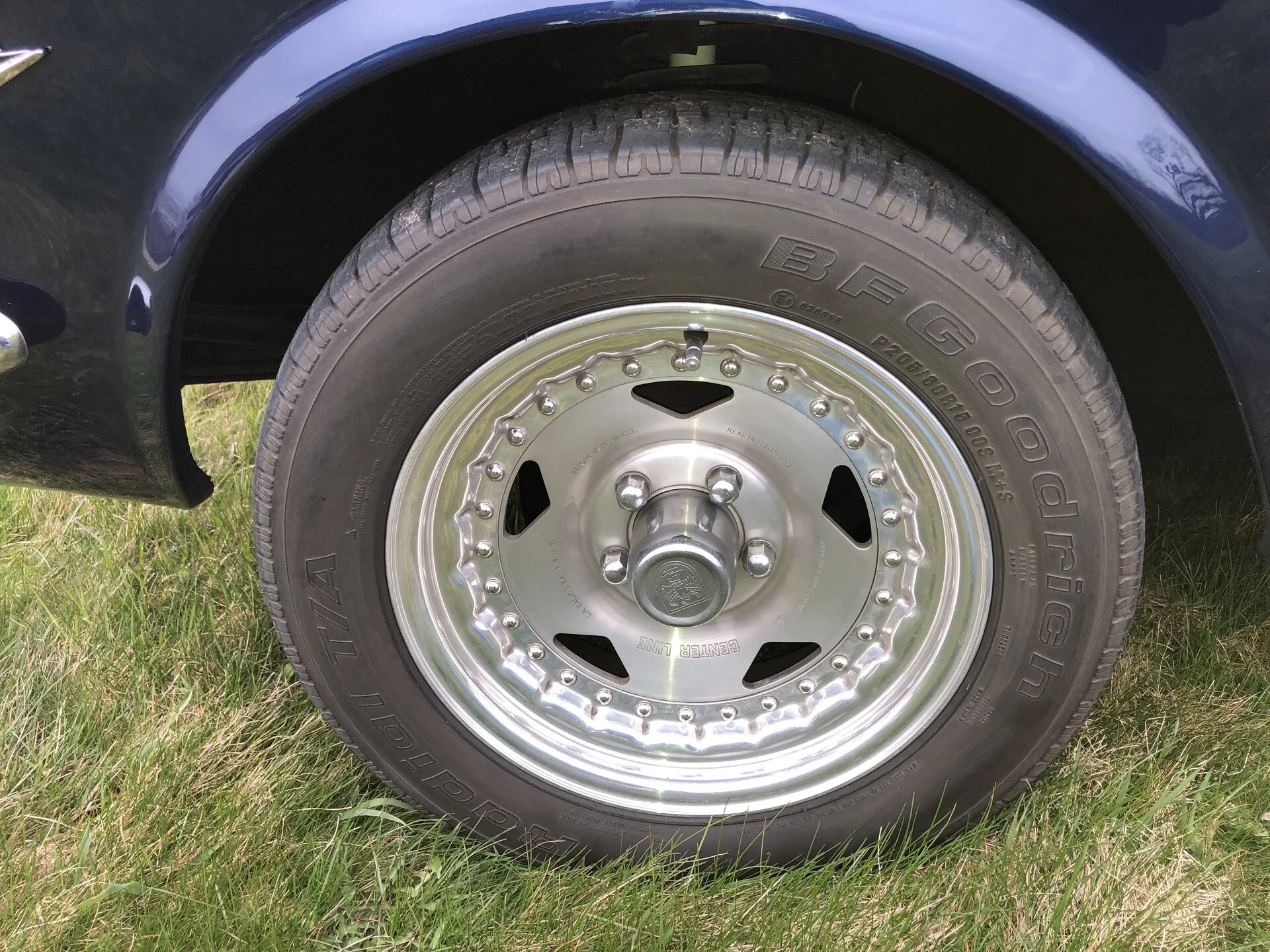

My 2 cents. I have a 65 mustang that currently has Center Line rims and BF Goodrich tires. Front 15x7 205/60/R15 Rear 15x9.5 P265/50/R15
I am installing Willwood brakes and my Center Line rims will not work with the bigger brakes. I purchased American Racing Torque Thrust II rims and Falcon tires. Front 17x8 235/45/R17 Rear 17x9.5 P275/40/R17. Rims have a 4 3/4" backspace. From what I've read if you go with 245 up front they will rub unless you roll the fenders. There is a pretty good article in the mustangs plus catalog page 222 on backspacing and rims size. Hope this helps.
