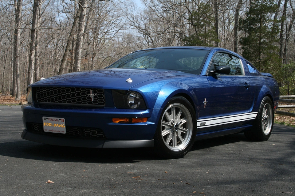

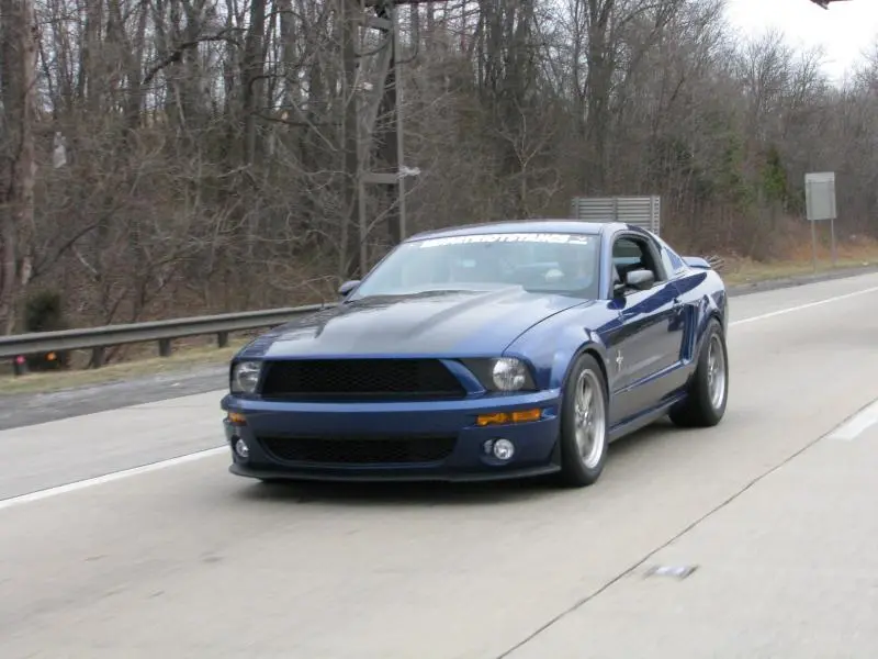

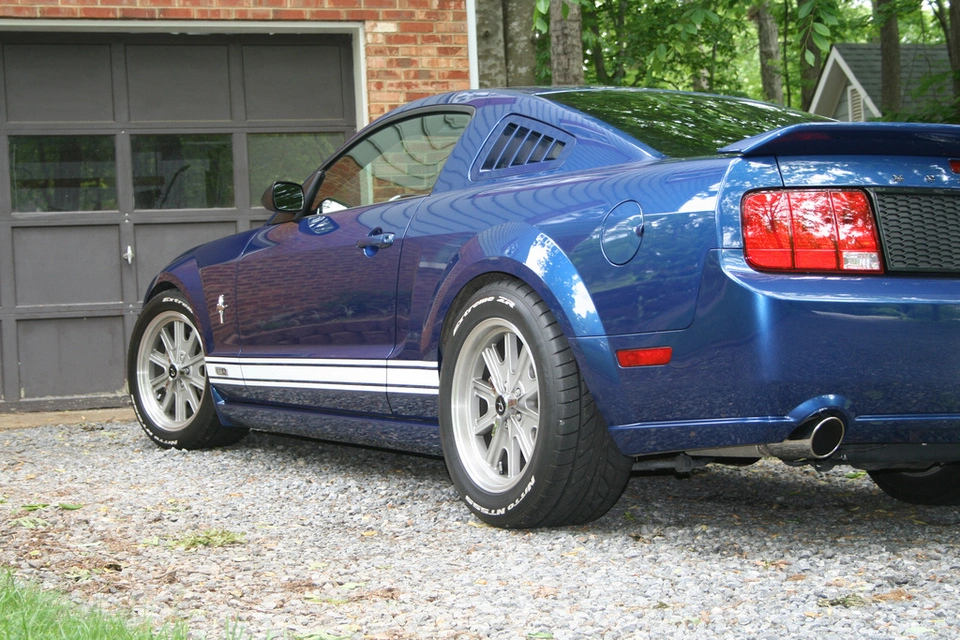

As Dark said, they will fit with no problems I also had to get an adjustable panhard bar after lowering. The wider the tire/wheel combo, the easier it is to spot being off center!
Here was my car with the same wheel size/tire size as Dark...
Since then, I've stepped it up a notch and went for the slightly wider (by .3") and much taller (by .9") 285/50 on the same wheel! Still no fitment issues at all
