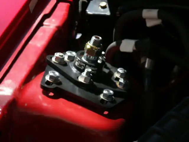

yeah ford dealer installed them i mean the car handles fine and stuff when i try to turn in a tight circle i can hear the tires jump and skid on the ground...all 3 spacers were used on the struts it sticks up high id post pics but it always says there too large to upload....ill try go get pics in a few min to show the look of install.
That does not look right to me... :scratch:
You would have rec'd 4 spacers (per side). I've got 3 (two large and 1 small) on top, then the other small one underneath - per their instructions. How many spacers and the manner in which they are installed (above or below) is determined by the drop of the car. Effectively, this raises the strut, thus wearing and handling better. Still, I installed mine, had it aligned the same day, and still had similiar tire wear on the pass side (not on the drivers side)...I think it's a crappy alignment. (SORRY THE PIC IS SO FRIGGIN BIG!)

You've got toooooo many spacers on the top of that strut. If you have the tools, just remove the nut from the top of the strut, lift the car until the strut comes out of the CC plate, and move at least two (if not all three) of those spacers to the bottom. Then take it to a tire shop and get an alignment.
If you don't have the means to DIY, its ok. Most tire shops will be able to do that for you. They'll probably know as soon as they see those spacers on the strut shafts anyways.

1 short on top and 2 long and one short on bottom... for all other struts install 1 short spacer below the spherical bearing. install 2 long and 1 short spacer above the bearing. there should be a total of 4 spacers per side and the install manual shows the pic of it with the 3 on top like mine
http://www.maximummotorsports.com/ page 4 of install under front suspension mmcc9994.
so according to max motorsports its installed correctly anyone have a pic of theres installed on there 94 up mustang?
