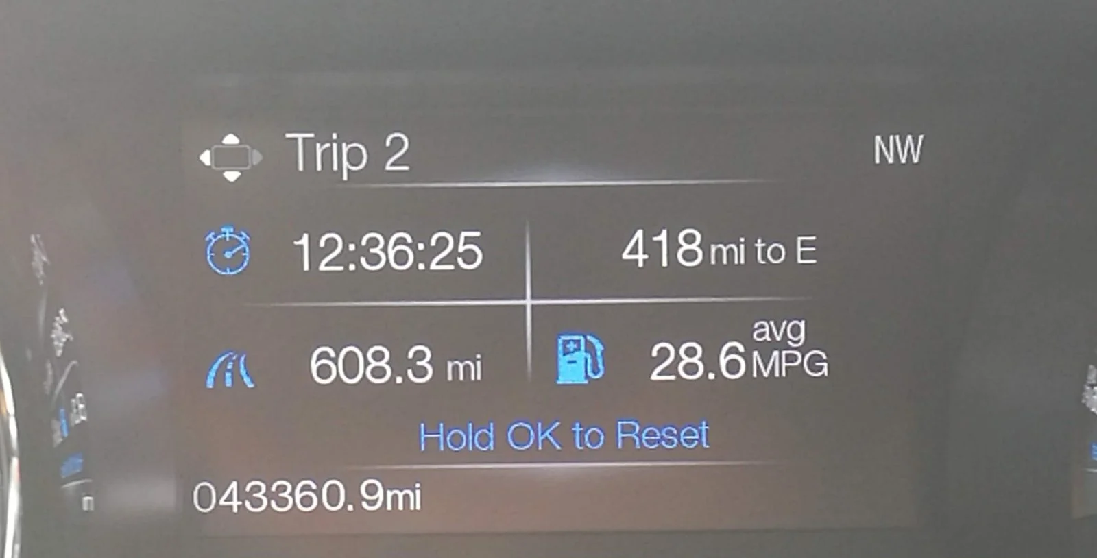

Here's what i get on the interstate using 87. 10% Ethanol too. ;)

I have the 3.31. 95% of my driving is highway miles. That particular trip was several 100+ mile trips combined. I average about 25.7 with all my other driving.
Nice. My commute is about 2mi, mostly stop and go, sit and wait.
It’ll be interesting when I DO get all highway miles in, where the MPG ends up.
