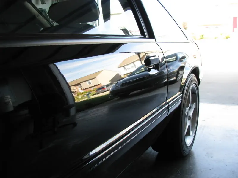

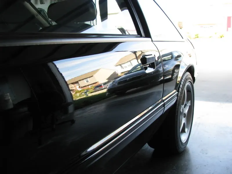

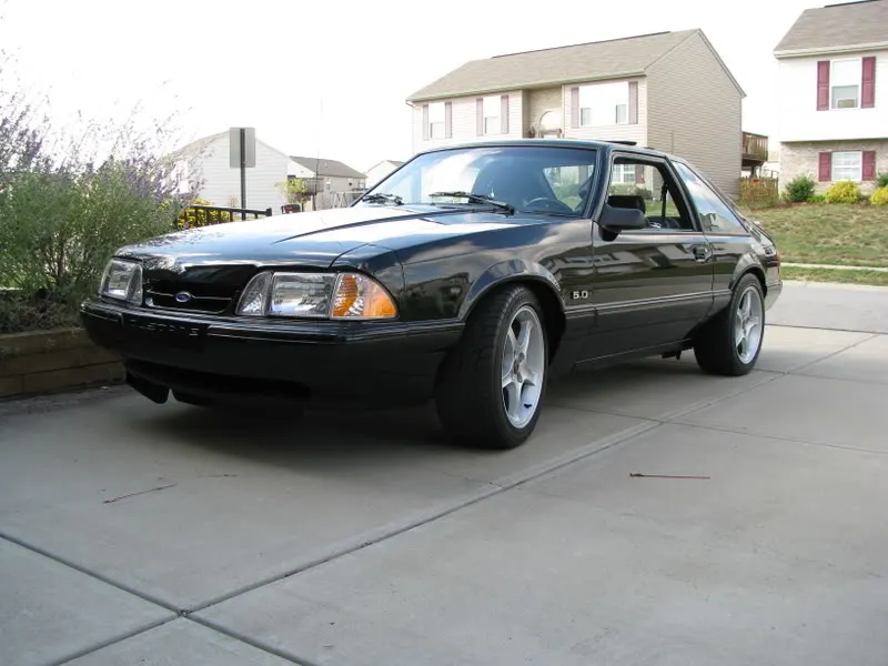

I have 245/45's on mine as well....same wheel as what you're looking at. My car sits pretty low and no rub on the fenders. Well it did rub with 1/4" spacers in front, but took those out. Now it only rubs at full turn. I don't think they look stretched at all.
