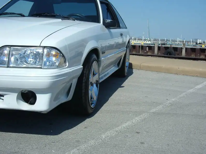

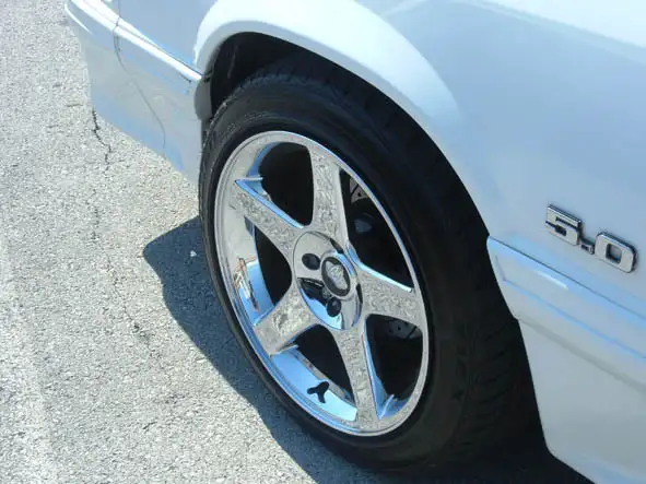

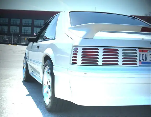

Right now i'm running 245/40's on my 18's and they look just fine. Actually, they look great. But now i'm going to 265/35's on my rims because i prefer a little meatyer tire. Otherwise they were a great tire... Here is a few pics so you can see for yourself. As for clearance rubbing issues, i'm going 265/35's on all four corners. Rubbing shouldn't be a problem from what i've calc.

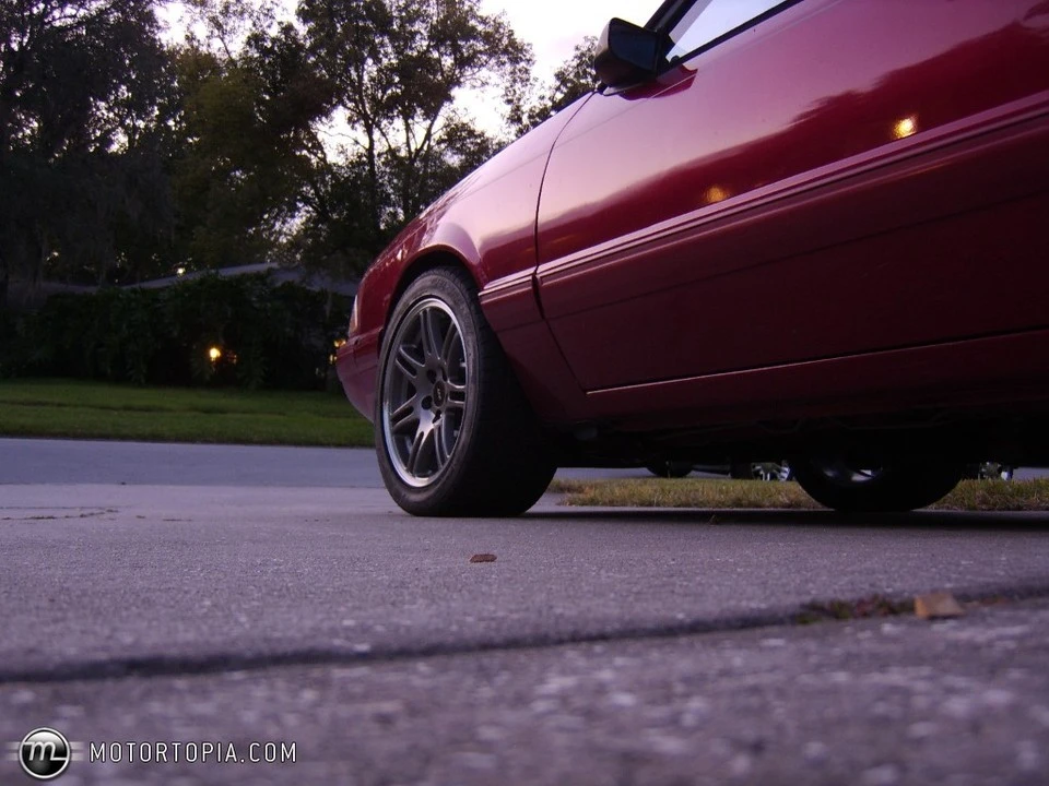

Here's a pic of what they were talking about the tire not being wide enough...
Those should give you an idea of how it'll look.
Thx for the pics. It looks like 245's are def too narrow...I at least need a 255 up front ut would prefer a 275, I just need to find out how difficult it is going to be to get that 275 on there.
