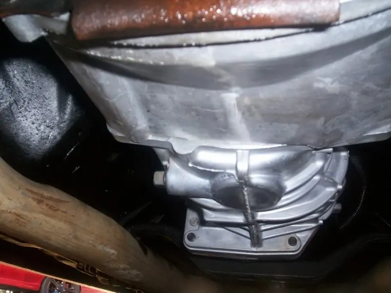

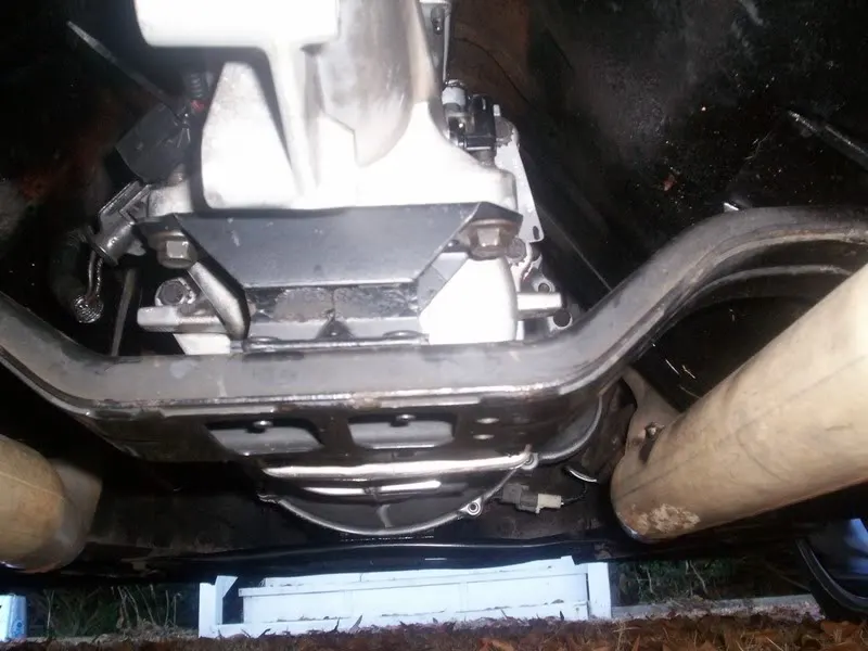

i removed the t-5 and installed the tko in just under 5 hrs by myself making a run to the parts store for a new throwout bearing...it shifts great almost impossible to miss a gear.

5 hrs without a hoist and a cast from my foot to my knee (i had ankle surgery 3 weeks ago)plus making a run to the parts store..lol ensure you have exhaust flanges where you can remove exhaust from headers and before mufflers i had some flanges welded in before install so i could remove exhaust at mufflers....
