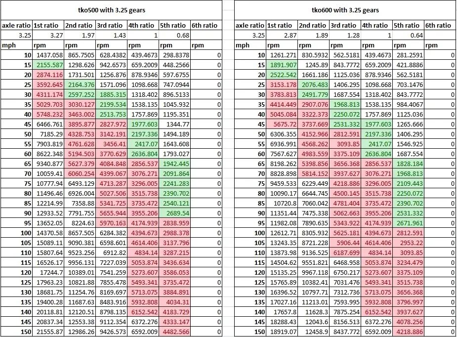

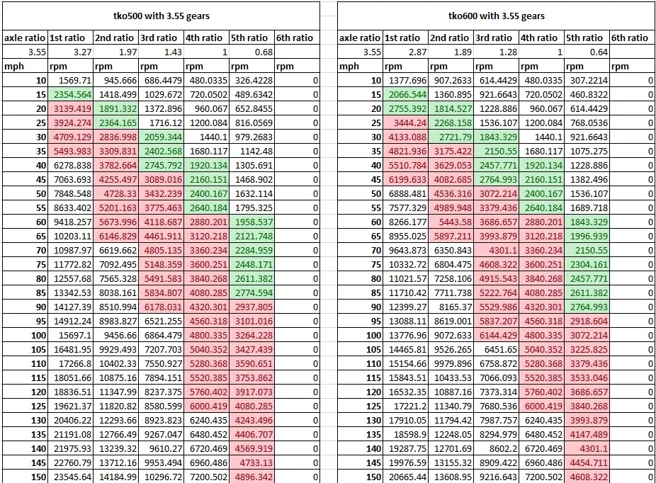

I spent a little time in Excel to see if I could get a better look at the big picture. It is probably also important to say that changing rear gears isn't that big of a deal, but I'd like to get whichever of the two transmissions would be best for a driver.
the parts shaded in green are between 1800 and 2800 rpm, which i figured would be acceptable rpm for cruising. i used to be around 3000 rpm at 65 with the c4, which was doable, but higher than I liked. The parts shaded in red are the rest of my rpm range up to a redline of 6200 rpm
Here are both transmissions with the current 3.55 rear gears:
and here is what it would look like with 3.25s
