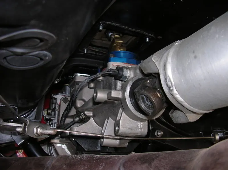

I notched the tunnel support and then boxed in the cut out area to regain most of the original rigidity (and make it look cleaner). I also used an offset shifter which places the shifter about an inch left and back. This way the shifter is closer to my hand without leaning forward or having a steeply raked shifter handle.
what mount did you use?
I think I got the crossmember from Dallas Mustang. It wouldn't suprise me if there is only one manufacturer, most shops seem to carry them.

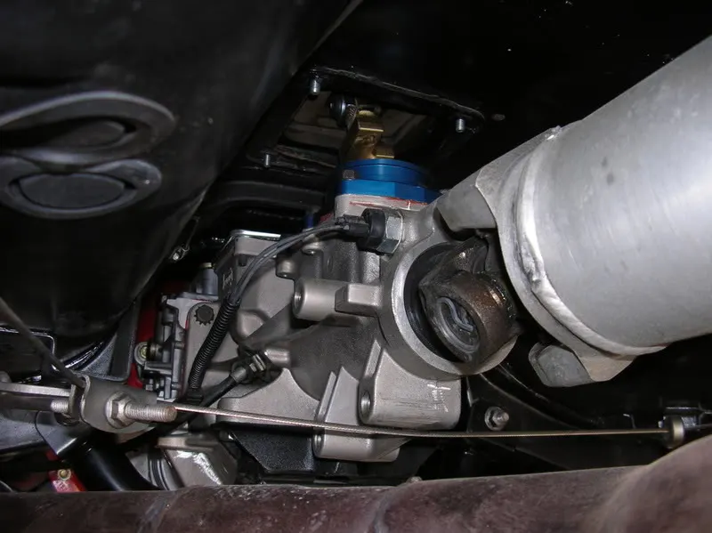

It fit fine as is but to improve the driveline angle I cut the rear mount off and welded it up higher. Roughly one inch higher at the rear of the trans made the front of the trans a half inch higher which is what I gained from my tunnel mod. You could accomplish the same thing by using spacers on the rear mount which is what I did when I was mocking things up.
