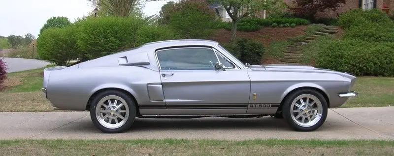

I think in all this we should be talking about the ride height of the rear of the car as well as the driveshaft angle, since one obviously effects the other.
I wonder if we could agree on a point, probably on the frame rails, that is common to all years of cars, and measure ride height from there?
Rear ride height doesn't matter. That only changes the driveshaft angle and that is only a problem if it is so severe the u-joints bind. Unless you have a 4x4 or a donk, that shouldn't be an issue.
The pinion angle will not change as the suspension moves up and down. It will change some during acceleration due to spring wrap. I am not as familiar with G-Bars and EVM 3-links but, by design the pinion angle should not change as the suspension (ride height) moves up and down.
You want your pinion angle to be equal but opposite the transmission angle. You can adjust it with shims on a leaf spring car. Check your installation manual for the 3- and 4-link suspensions.
The only way to change the transmission angle is the engine mounts and/or the trans mount. You are some what limited with how low you can mount the engine (using factory style frame rails, i.e. not Mustang II). The trans tunnel limits how high you can raise the trans mount.
