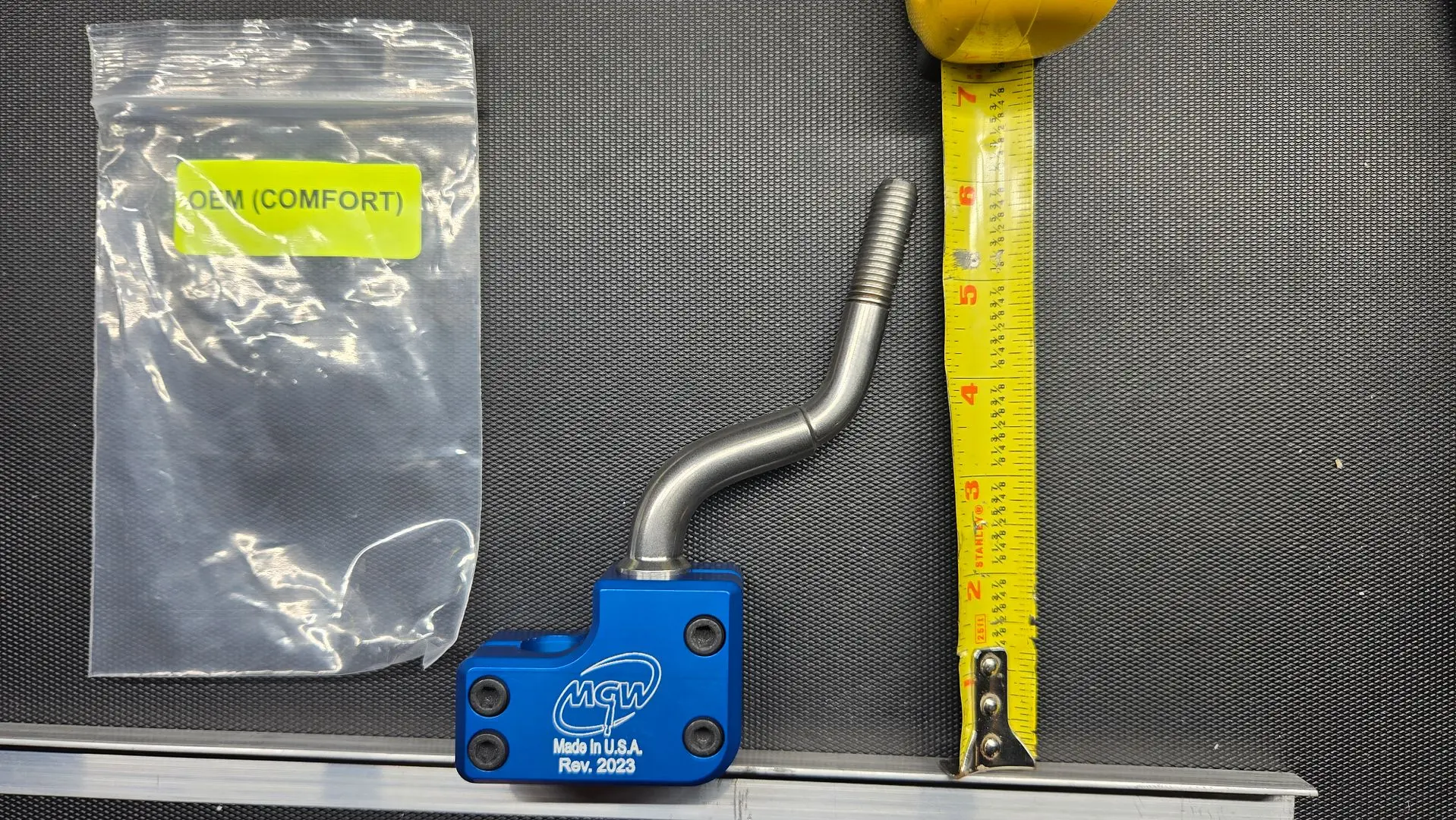

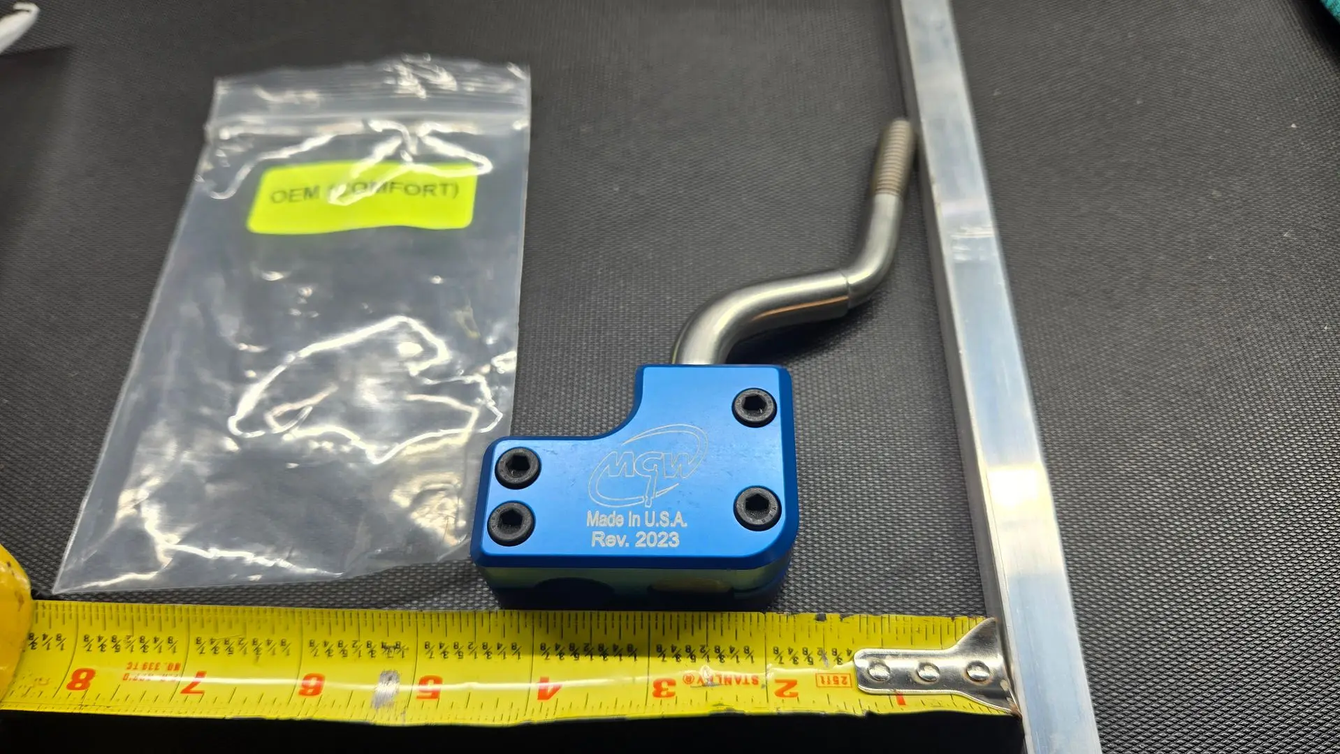

I have a MGW on my GForce and love it. I wanted one for the TKX but I need a handle that curves back towards me. They show only one handle that's straight up and down. I sit in a solid mounted Kirkey seat and I'm held in place with a 5 point harness.
I'm super interested in this as well. Please post pictures when you get it in. It's very hard to find info regarding the TKX and '94-'95 installations. I want to put one in my car, but I don't want to cut up the sheet metal to make it fit. It's been a long time since I've had it apart, so I don't remember how much extra room there was around the T5's shifter. I'm also wondering what this will do to fitting the upper boot around the TKX's shifter.
As far as the reach goes, the SN shifter location already sits pretty far forward for someone like me with long legs and the seat as far back as it will go. I think the guys are right that an MGW will be the best way to recover the one-inch passenger side bias and get the shift knob far enough back. Their "comfort" shifter has a stock-style kick back which might work.
