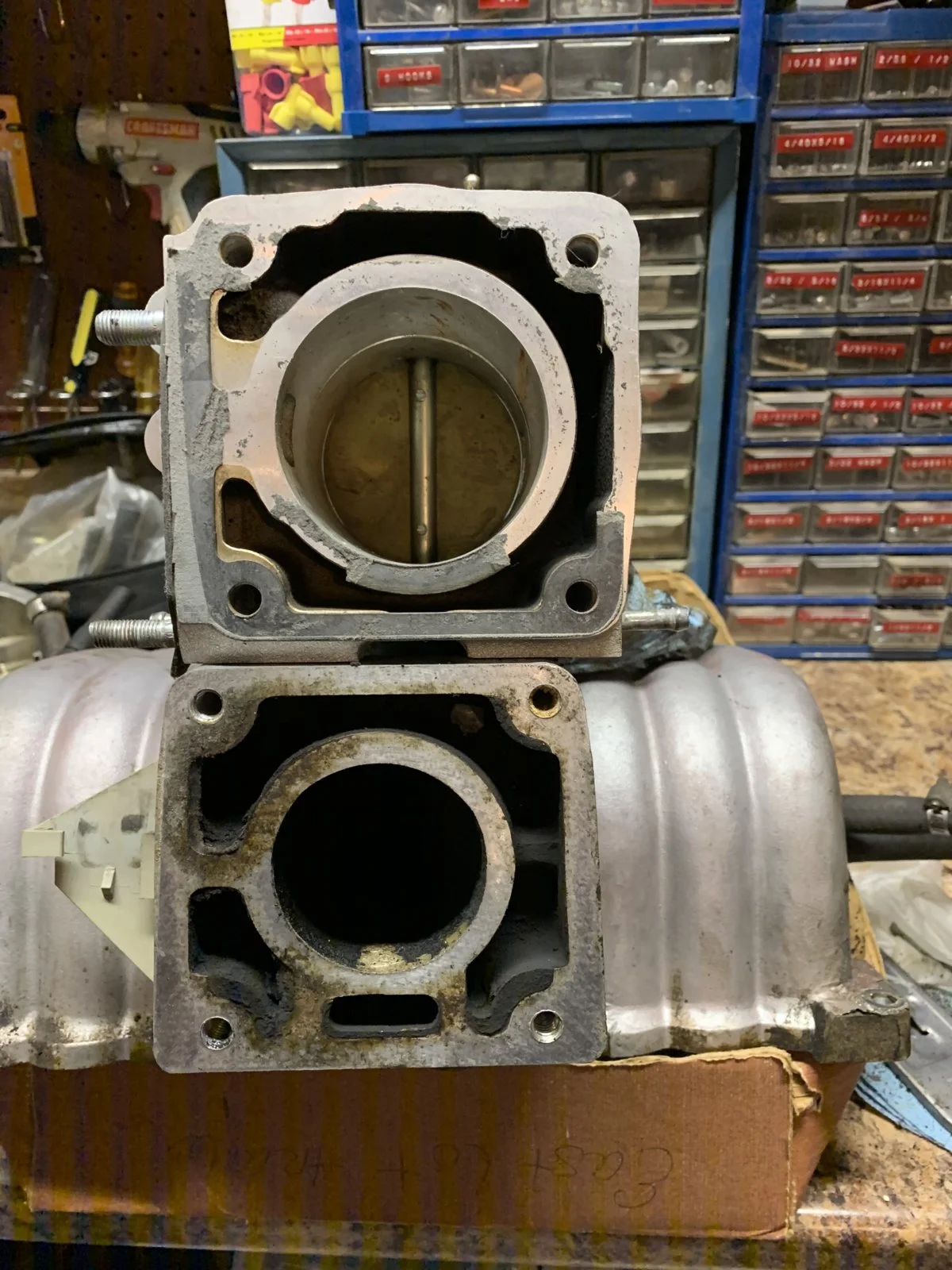

A question, I just bought a 70mm throttle body and was told that the opening needs to match up with the opening (didn't know) on the stock upper intake manifold and if it didn't that I could just dremel open the hole...WHAT!!! if I Dremel the manifold there will be no hole! Thoughts
the top pic is the TB and on the bottom is my stock IM

Simple. Scribe a 70mm line where the TB will be on the stock upper. Use the gasket to match it up. Grind material until it matches while carefully blending it into the intake. Hard to describe...very easy to do. Basic gasket matching. And it's been done thousands of times so there's probably some pics somewhere. I'll see if I find one.

Whatever you do....do not allow the metal shavings to get inside the intake. Stuff a rag in there and make sure no metal gets in there for it could be bad.
It's very easy to open up the intake. Just take your time and grind a little at a time.

Yes. I'm too paranoid to do anything like this without taking the part off the car.
Save the throttle body for when you do a aftermarket intake and heads. It's a complete waste of your time to port a stock intake for a 70mm throttle body as the intake and heads are the majority of the restriction.

In reality though, I seriously doubt getting a perfect port blend between the throttle body and intake is going to make any measurable difference whatsoever. Theoretically that is a great idea, in reality, you are going to end up with a shard of metal in the combustion chamber. I'd just bolt it on and enjoy it.
I would have to agree. 70mm on a stock intake is a waste of time and a potential headache with idle.
Find yourself an explorer intake setup, and setup to swap it all on at once.
Also, you need an EGR spacer of some sort. Even if you delete the egr the throttle linkage connects to it and it keeps spacing with The intake tubing correct
