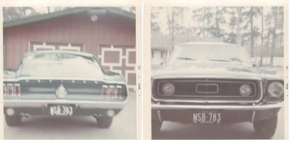

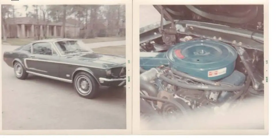

-The car is FULLY documented...I even have pictures dated March 1968 with the owners hand writing on the back about adding a shelby spoiler (He must've never got around to it). (and all protectoplate stuff and manuals)
- 'J-Code' 302-4 barrel, Highland Green, 3.25 axle ratio, 3-Speed Manual, GT Equip Group, AC, AM Radio, Reflective Group, Remote LH Mirror, Wheel Lip Moulding, Electric Clock.

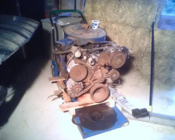

-Aside from the second owner taking the engine, tranny, and font clip off (I have them) this car is 100% complete. The engine looks like it did in 1968 (It's just rustier and not in the car).

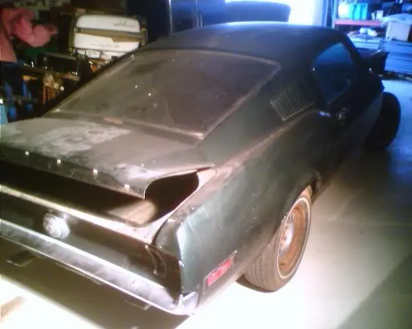

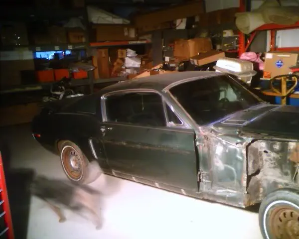

- VERY minor rust issue in the lip of the trunk. No other rust on the vehicle that I could find. Right side looks like he drug a highway marker or something down it and did a basic repair and cheap-o repaint.

1968 State:

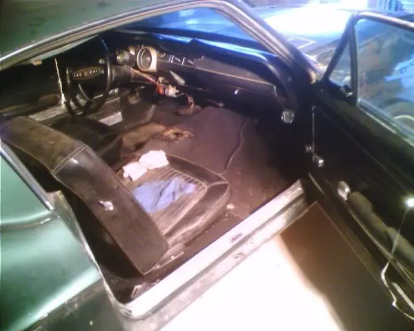

Current State:
