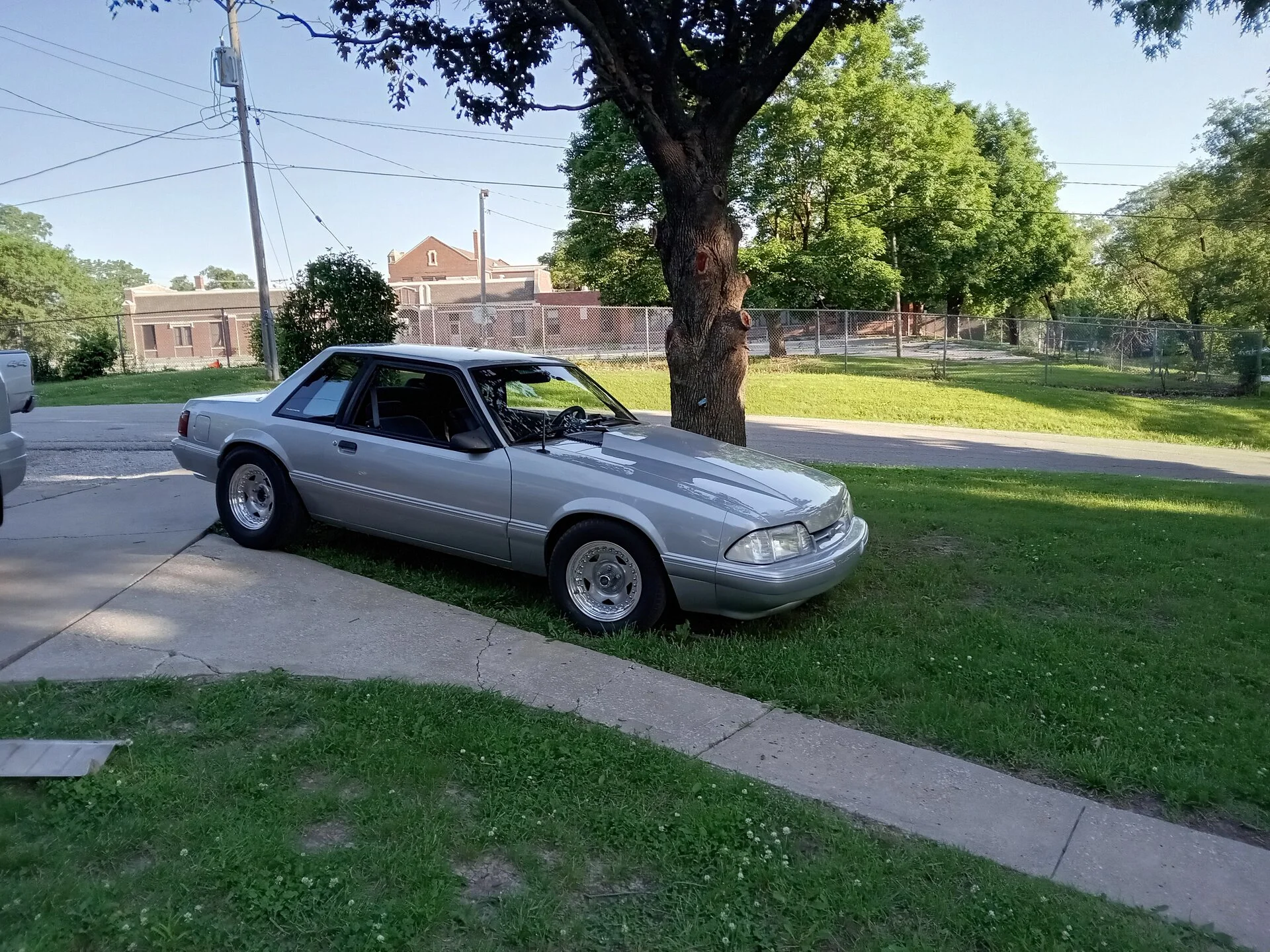

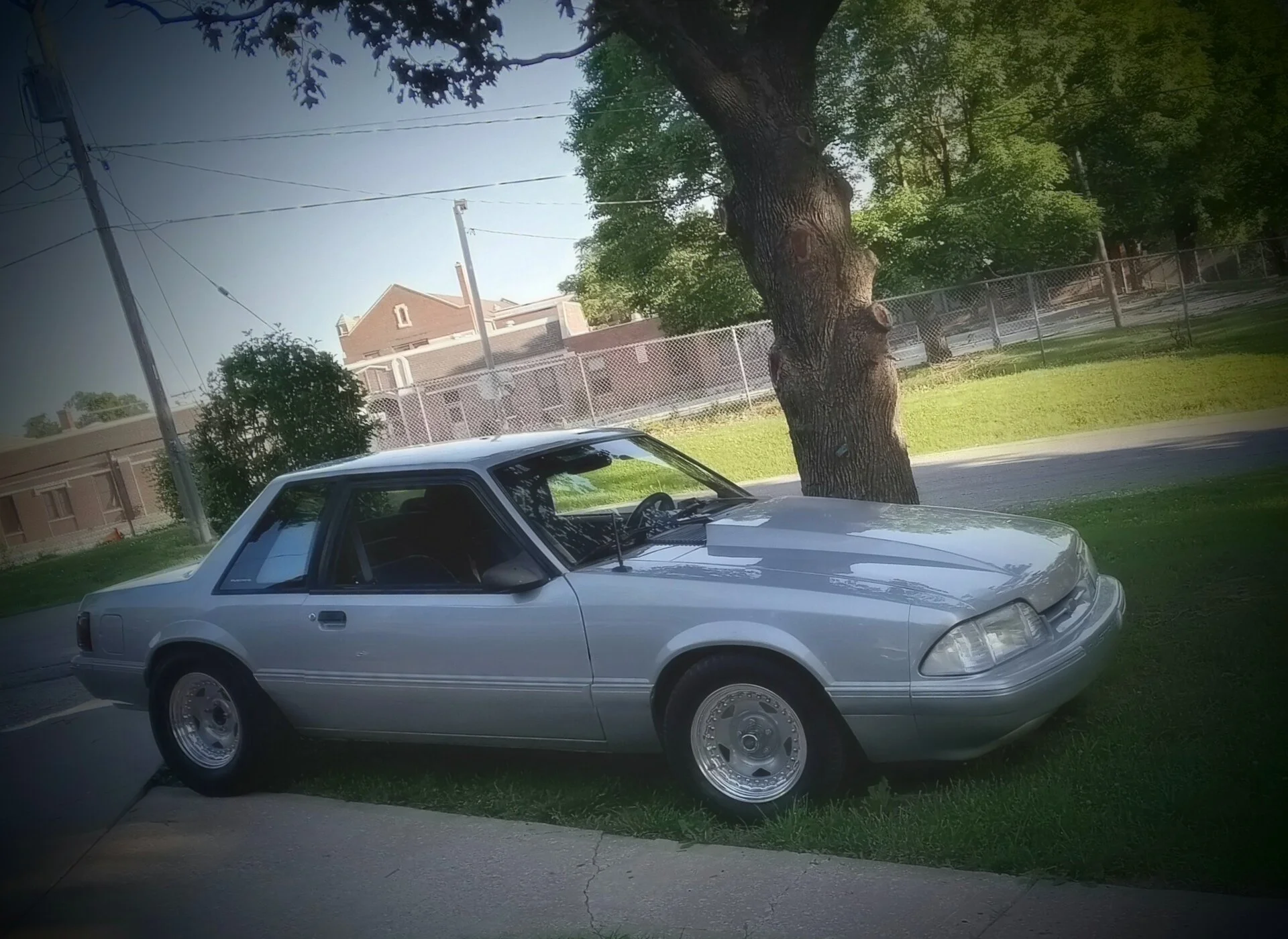

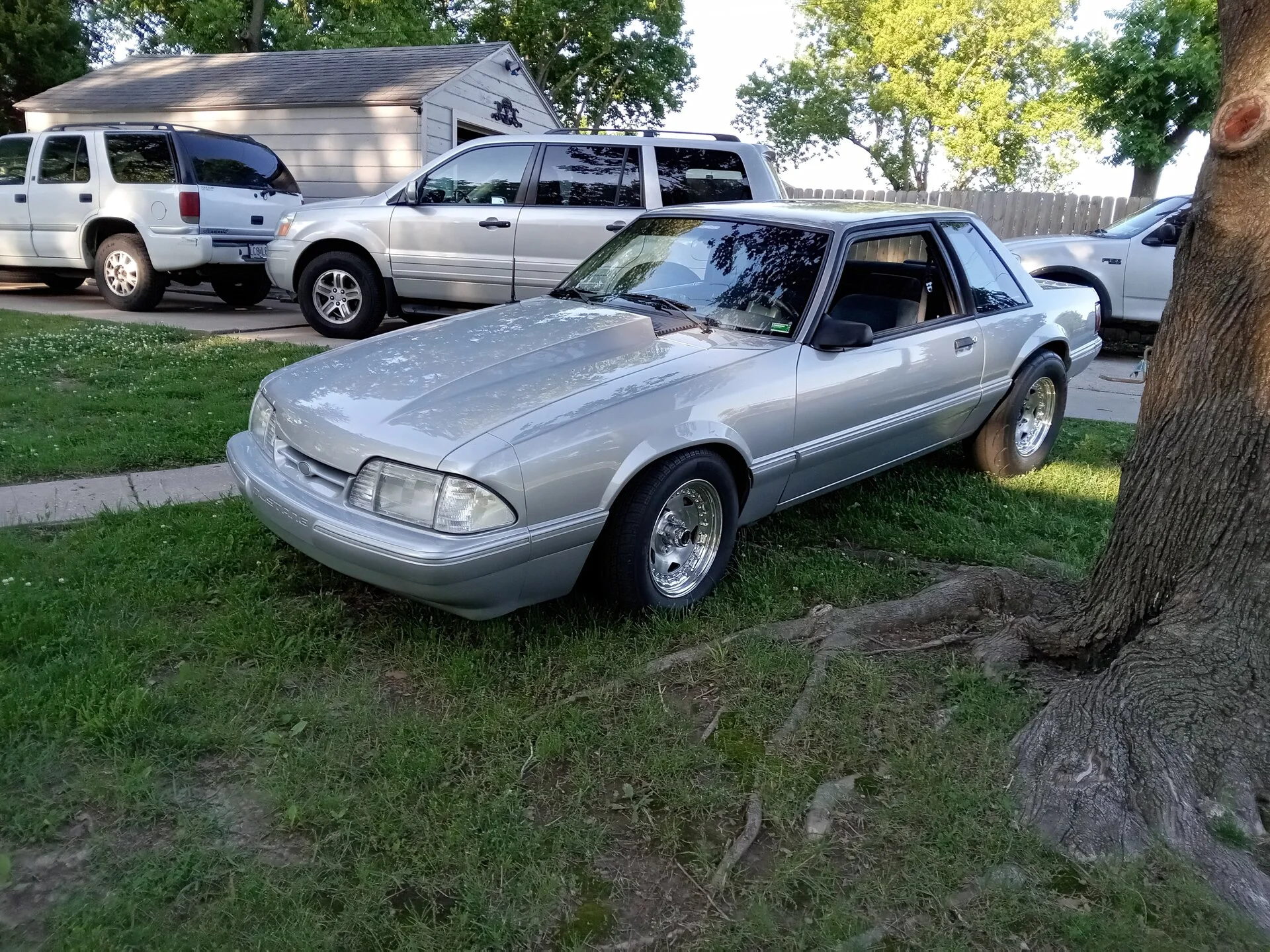

The car is far from ratty or
clapped out
