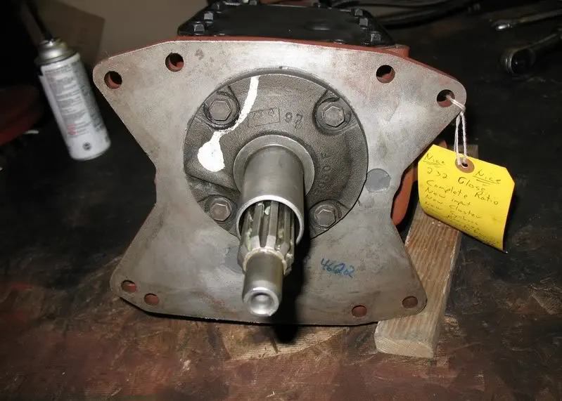

There are actually 2 possible bolt patterns for the toploader. The early 64-65' bellhousing had holes spaced closer than the later models, and the toploader was built to match with short mounting ears. Late 65' and newer toploaders have both the original narrow pattern plus the more common wide bolt pattern.
Here is an example of both patterns on a newer toploader:
