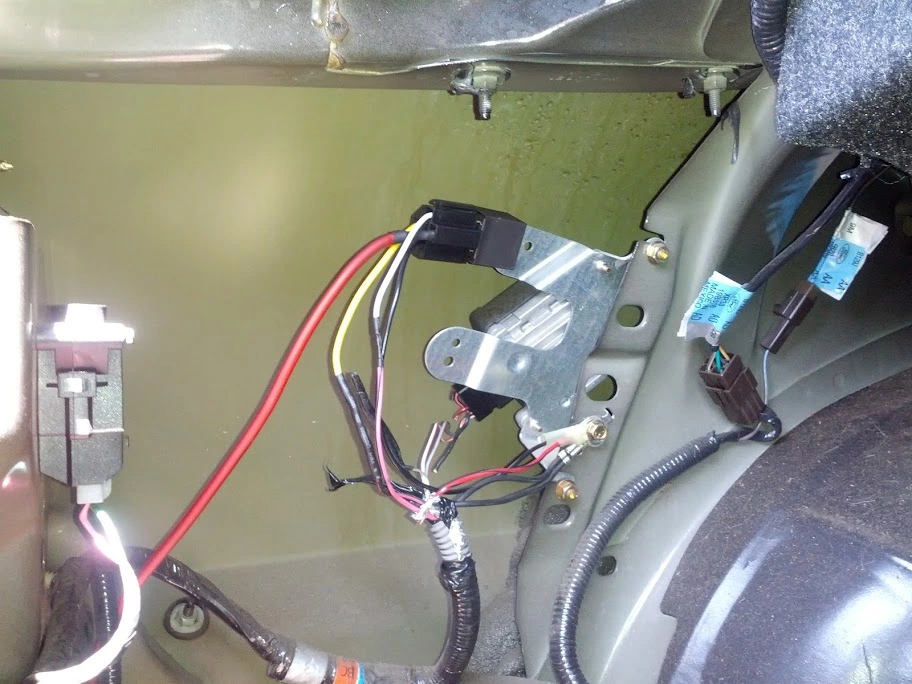

I have the SVT Focus pump as well. I will being installing the 40 amp supercharged Boost a Pump before I move forward with headers and a smaller pulley. My tuner told me my pump is running at nearly 95% duty cycle and thats with a centri and around 370 rwhp. I figure its a worthwhile investment.
yes it is. I went with the JMS powermax PM1000. My tuner recommended it over the KB BAP. He said that the KB BAP causes a spike in fuel pressure while the JMS unit slowly ramps in
Running dual ford gt pumps with a return style setup, bypassed the FPDM. Setup is rated at 750-800hp w/o a BAP.;)
