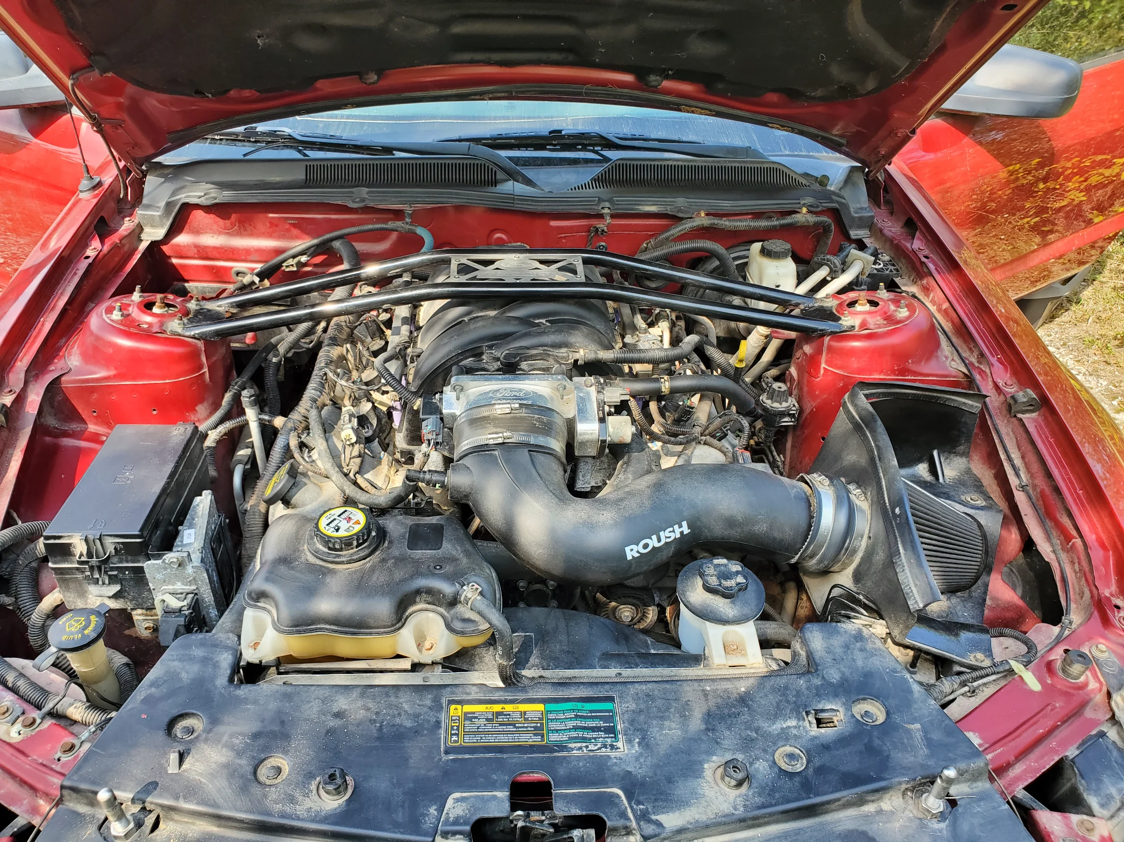

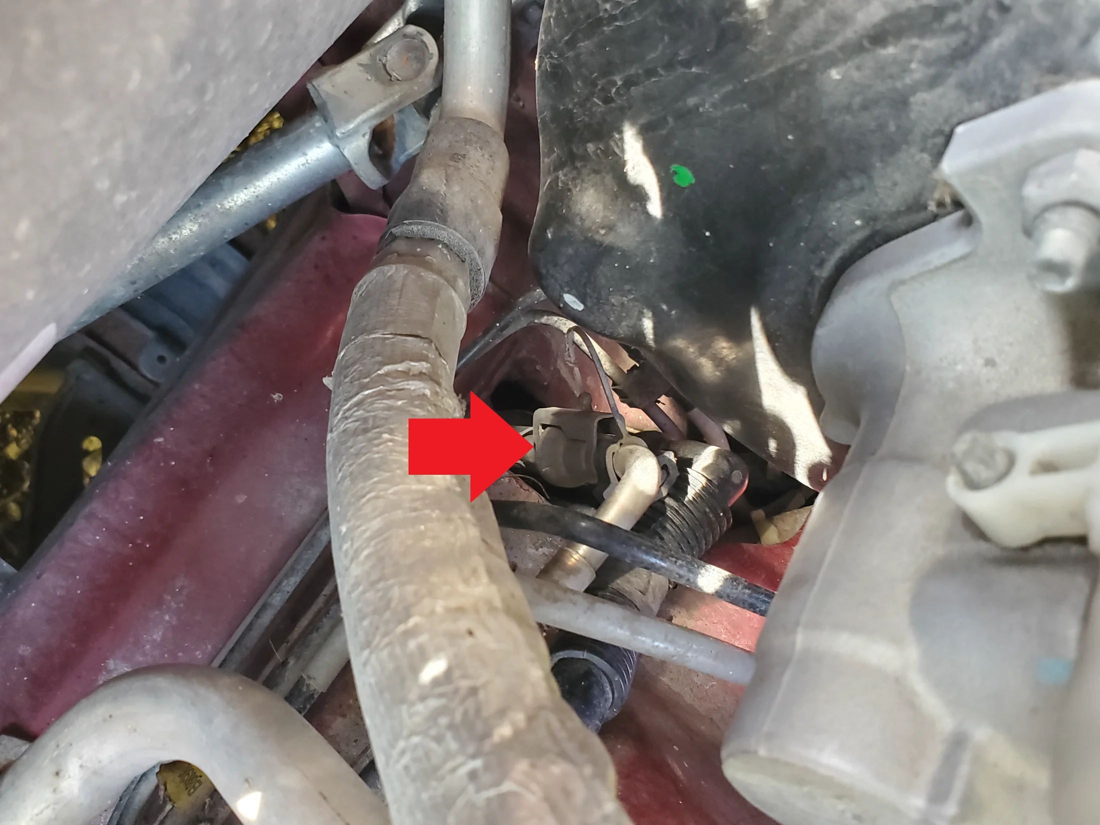

Thanks. I was looking under the hood for where to disconnect a fuel line but I'm not seeing much. I know the previous owner had done some racing type mods so idk if that changes anything. I've attached a pic of the driver side of the engine with me pointing at what I think is the fuel line. I'm probably mistaken but it looks all metal and I don't see anything to disconnect. There is that black hose above where I am pointing but it looked like that went to brake system. I've also attached a pic of the whole engine bay if that helps. Thanks

Follow your fuel rail around until you find the regulator. The pressure line disconnect is right there.
Thanks. I'm having some trouble finding it though. I've traced the fuel line from the rail to deep down into the engine bay but it doesn't look like it connects to a part that looks like a regulator. I've searched and searched for the video of someone replacing a regulator on a 2005-2009 Mustang GT but the only one was a guy who was replacing the regulator sensor, though he called it a regulator.

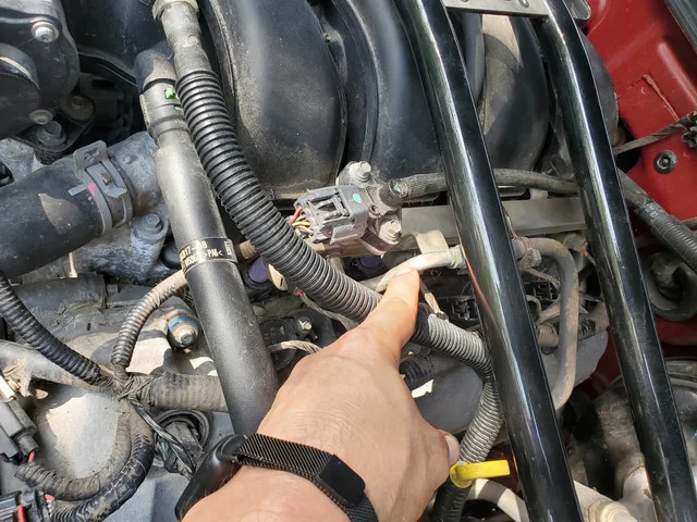

I've attached an image of where the line from the fuel rail pipe/hose ends. I've even watched videos on replacing it for other cars but it didn't help. Can you see the regulator in either of the images in the first post? Am I just way off base? Thanks.

That looks like a fuel line, yes. Now just need to make sure its a feed line. Cant really tell much from your pics but im guessing that the ecu regulates fuel pressure, hence the need for a sensor. Either way you should be able to disconnect from where it taps into the rail.
Maybe watch that video again and see how it is installed. Have you worked on fuel systems before?
