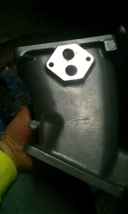

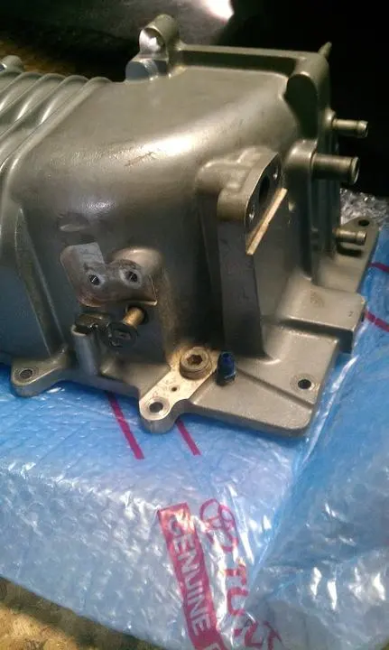

Show me some pictures and Ill tell you what they are.
If you are talking about the brass butterfly on the bottom of the blower, that is the bypass. The EGR is on the back, drivers side, at the top. Also back there, is another 3 hole thing. It would be down on the base, a central hole with 2 bolt holes on each side. That is the Cobra ACT, you can block that and run the Lightning ACT sensor.....Its easier!
The DY-1159 will work. Ford used that on a lot of different vehicles. There is an adapter to allow you to run the EGR if you want. I am not running it, but then again, I dont have emissions/inspections.
The first pictures is the IAC. Tork Tech says you can reuse your stock one, but it make it stick up really high. Get a cobra IAC, and a cobra TB. That will take care of that.
Second picture is the EGR and rear vacuum ports.
The thrid. The bypass is gone, so you will need one of those, and the Cobra IAT sensor hole is already plugged. The allen head stud is what is plugging that.

That looks like a hose barb to hook up a boost gauge.
If you choose to run EGR it's real easy. Get the manifold-valve exhaust tube from on 03-04 Cobra, and the EGR valve for one as well...everything just bolts up. I did it just in case I have to move to an inspection state, and EGR's do not effect your horsepower. Ford sells the tube new, and you need to be careful when ordering the EGR valve because most places will give you the same one as a GT, but the tube hook-up faces the opposite direction as your stock one.
