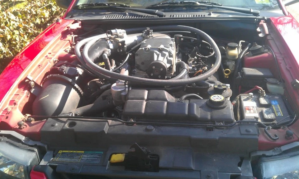

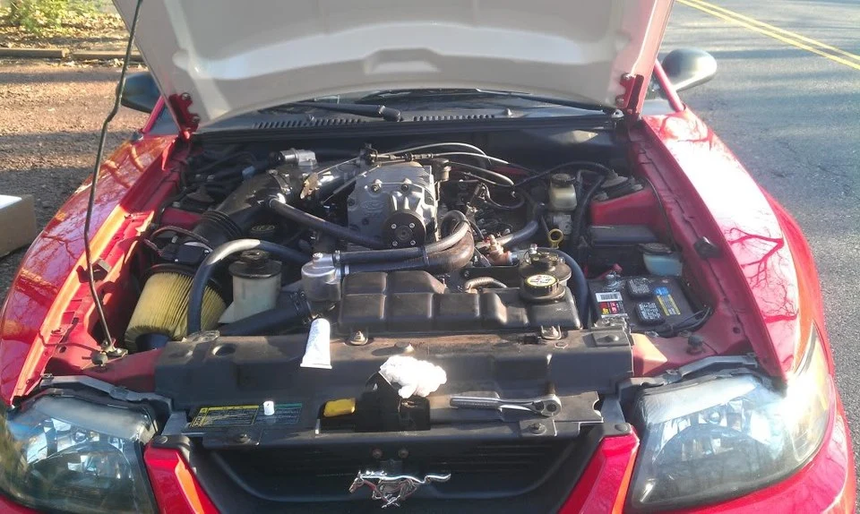

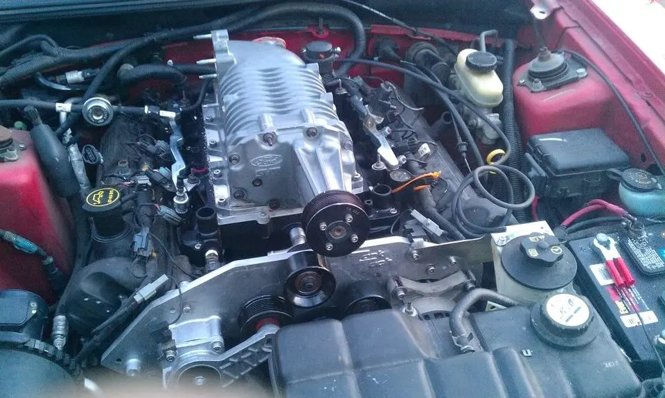

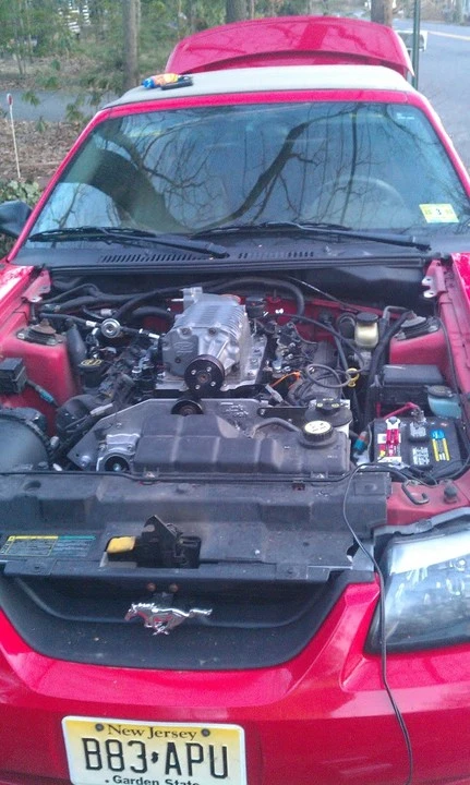

Do you think it would be possible for you to give your parts list on the install? Im in the market for a blower and have looked into Tork Tech, but I am so turned off by all of the parts sourcing you have to do. I would really appreciate it
That is actually the great part about it...you can do what you want. Bob bought a few new parts and a few used ones. He even used a power steering reservoir for the coolant tank. I bought all new parts for mine, and there is a big difference in price between ours. That is the beauty of this setup, get what you want, when you want, for the price you want. There are really not that many things you need to get. I looked on eBay today for parts, and I could get almost everything I needed for the actual engine part of it for $1000-1200.....including blower, tb, injectors, sensor, tb cable, heat exchanger, pump, MAF, IAC. I dont think I really looked for a CAI or the 19mm hose for the heat exchanger, but you should be able to find that pretty cheap too.
Bob was right about the KB 2.1 being 4800. Sure, but if you want anything other than the base kit...that is up to you. I had well over 6k in 2.1 KB with the kit, TB, Big Tube Kit, and 2 extra pullies.
Bob also talked about upgrades....and that is the beauty of it. ANY 03-04 Cobra blower will fit it. KB, Whipple, TVS, Eaton....the list goes on. Have you ever wanted a 4.0 Whipple on your 2v? I have a friend making over 510 rwhp with Patriot heads, Comp Cams stage 2 cams on a stock 96 shortblock with less than 10 psi. You arent going to do that with a KB....
