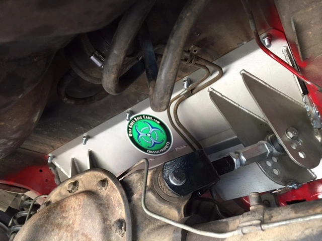

There are couple companies out there that make some beefy replacements. I think most folks try and repair existing with reinforcements.
Here's what a replacement torque box would look like:
You can find those in ebay. They're made by Wild Rides.
Because of your question, I went and looked around a little bit to see what turned up. This is new to me. I have not seen these before:
Here's a link for them: 1979 1993 Mustang Torque Box Set Adjustable Heavy Duty | eBay
This looks like it would require some better than average welding skills so as to not warp the sub-frames.
The Wild Rides version can be done on the garage floor.

I have the Wild Rides one pictured, possibly for sale. I'll post over in classifieds if its is.
Its pretty hefty.

The wild rides upper S box is really nice.
Price is lower now than it used to be. Old price was like $550.
They even make a lower replacement kit Wild Rides Lower "S-BOX"™ 2.0 Kit - WILD RIDES WILD RIDES

I have Wild Rides on mine im happy with, way back when Rick from RNH perf. was doing work on my car i remember him telling me he made them but i already had the wild rides on mine.

I have the wild rides box in my car and while it's ok, there are better options out there now.
Double AA Performance Multiple Adjustment Upper Torque Boxes
JCR Chassisworks-Drag Race Chassis Construction and Components
lyons custom motorsports upper and lower torque boxes installed pics - Yellow Bullet Forums
"If" I were to build another car, wild rides parts would not be my go to. Not that they don't work, just no longer top of the line. Fwiw my car has been 1.19 60' on a 275 radial with the Sbox

The purpose of the Wild Rides is replacement without having to destroy half the car to do it or measure your own angles with a chassis jig.
There are perhaps 6 people on this entire forum that could do a proper install of the ones T-Top listed. I've seen a couple hack jobs too. You know the ones... The wheels are straight but car isn't.
The top link maybe... Everything else. GTFO a here.
