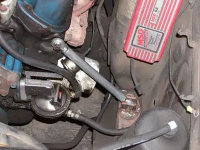

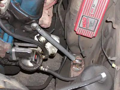

The motor is out of the car right now so I took a photo. The ends are welded, it has a lock nut on the right hand thread side, to hold it still and the chain links mount under the sway bar mount, to the sway bar bolts. I had to use a longer bolt for that hole. The top mounts to the head of the Cleveland in my wifes '65 coup. The top is the upper left. I make it hand tight, then give it 1/2 turn more as a pre-load. No problems yet.
