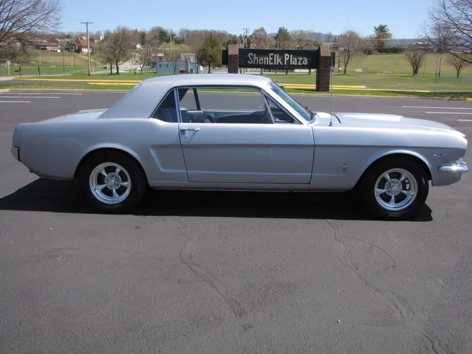

If you are close to VA (22827)I have a practically brand new set of Torque thrust II wheels and tires with less than 500 mileson the set for sale.
tx65coupe
1,551
37
Nov 12, 2009
  • Nov 12, 2009
That looks slick, why did you change it?
B
Bulldogstang
Mar 12, 2002
VA
Nov 12, 2009
  • Nov 12, 2009
I want a wider set of wheels on the rear and these are 7 inch all the way around.
Thinking of going with a set of Billet Specialties on it.
