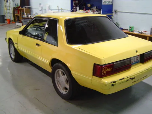

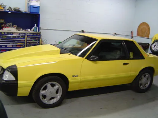

Hey guys. I been into european cars for awhile now and while they handle great, they just cant be made "fast" without spending a lot.
So as a weekend car im thinking of selling my current 88 BMW 635csi and jump into a mustang. My daily driver is a Audi A4 if that matters.
Heres the one im currently looking at.
For sale yellow 1991 mustang notchback 302 with cold air, Mac headers and Mac off road x pipe 1 chamber flowmasters with dumps gt40 heads e303 cam, steeda tri ax short trow shifter. It has m/t et sreet radials in the rear 265/55/16 air pump eliminator bracket a/c eliminator bracket 4 inch cowl hood and more I can't think of at the moment. The car is a texas car and I am the 3rd owner car has never seen snow or salt has only been in this state for a little over 2 years, very stong car and motor not sure of times never had it to the track yet should have close to 300hp from all bolt ons. Asking $4200 or best offer car needs to go very soon the to make room for new mustang.
I went to go look at it since its my buddys friend who is selling.
It needs work cosmetically since it was a repaint. It used to be red. The interior is pretty clean but theres no headunit. Would have to find one. Of course the front, trunk and rear bumper need painting.
The car drives like nothing im use to. It hauls major ass and basically made me **** my pants. Its kinda hard to drive since it feels like it wants to cut out at low RPMs. Im thinking its the cams that are doing this? :noob: The speedo also jumps around but i think thats a common problem? Otherwise the car seems fine and ran like a champ, even in -3 degree weather.
Im thinking of going back to look at it some more but figured i would ask you guys on what to look out for. Also how does the price sound, hes willing to work with me so no biggie. He has other mods that he didnt list but i forget them all. Hes emailing me the whole list later on.
Also with his mods, what you think it can do in the 1/4?

Id look into it. If hes willing to compromise, take the car to macco, get a quote, and tell him what ever half the price is, to take off the price of the car. So basically split the cost of the paint job. And paint it red again. Just from the add you can tell the owner knows something. And the car only has one cam.
1st off welcome to Stang-Net... 2nd Glad to hear your Willing To change Styles.. Mustangs are deffenitly the way to go, and you came to the Right place.. Car looks Good Other then paint, and what ever other mods you are going to put into it..

Welcome to :SNSign: This place has a lot of great guys and girls, and is a lot of fun. I love notches, and that one looks pretty clean other than the paint issue. Show him $3500 and drive it home, but bring $4k like mentioned just in case.
