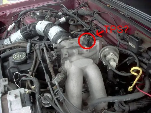

Hey guys i was following this tutorial http://www.muscularmustangs.com/maf.php
but the pictures he includes are not of a .2.3L so i cant really reference them. i believe i located my TPS, i think it attached to the IAC. Any information would be great, i included a couple pictures. If anyone could point me in the right direction that would be great.
Any Tips for recalibrating my TPS?
PS, if what i think is my TPS is, its got a stripped screw on it, i know part of the calibration involves loosening them, any info would be great!!!

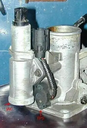

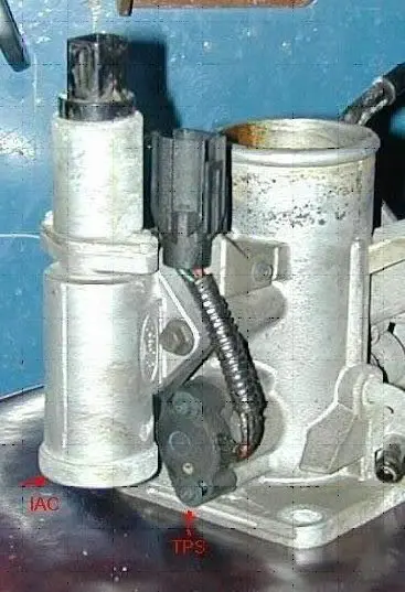

followed that wire, and it just leads to a Plug. not seeing anything that resembles the TPS in the pictures in those guides. will i have to take apart the 2.3l throttlebody to acess the screws im looking for?
is anyone familiar with doing this adjustment on the 2.3l? theres basically no acess to the TPS without disassembling the Throttebody. someone help me out here. Ive read that there are 2 screws, losen and wiggle till you dial in .98-.99v. i see no such screws.

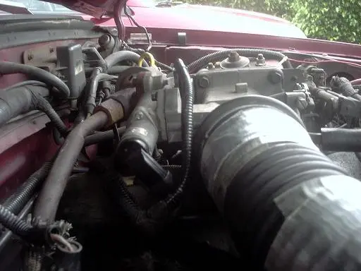

· Turn the engine off and unplug the Idle Air Control connector from the IAC. This is located on the backside of the Throttle Body near the firewall. This device is a round cylinder approximately 5 inches long with a (2) bolt flange and 3 wire male / female plug connector. (see picture)
· Start Engine. Using the small adjustable wrench on the idle adjustment screw, adjust the base idle to 700 – 800 RPM. (The idle adjustment screw is #1 in the picture below)
· Locate the Throttle Position Sensor (TPS) on the Throttle Body. This is also located on the backside of the Throttle Body near the firewall. This is a black plastic device with (2) screws that allow adjustment and (3) wire male / female connector. (see picture)
· Back probe the back of the TPS connector to connect the meter... The + (positive) side of the meter connects to the green wire. The – (negative) side connects to the black wire (SIGNAL RETURN). NOTE: you must connect the negative side of the meter to the black wire (SIGNAL RETURN). Do not just ground it to the chassis; it’s not the same thing. Back probing means sticking pins down the back side of the harness side of the connector for the appropriate wires. It can be tricky but is better than sticking pins through the wire insulation. The connector is left attached to the TPS.
· Using the small Phillips screwdriver to loosen the two hold down screws slightly, then rotate the TPS to change the voltage setting. Adjust the TPS output voltage to just under 1.0 volt. Most turbo tuners find that setting TPS voltage to around .90 - .95 volts works best. I set mine around .94 volts. When set, tighten the screws and recheck the reading.
