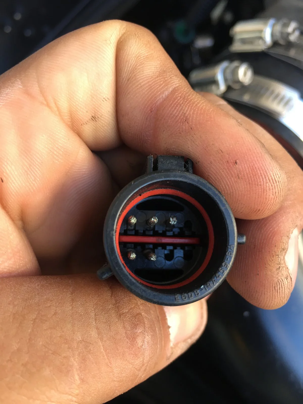

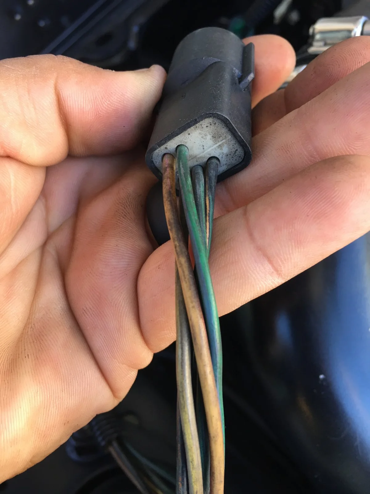

Step #1. Look for the o2 harness plug near where the MAF would normally sit on a mass air car. Is it a 5-wire plug or a 7 wire plug with a jumper.
Step #1 is that you are really going to need to identify what's on this car. I'd start with looking at the o2 harness to see if there is a jumper
5 pin o2 plug so that means what year is it ?
