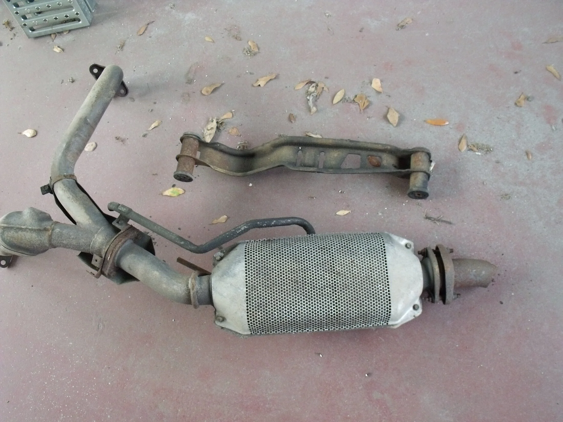

Picked up a Tremec TR-3550, Do I need a different cross member for this? Seems like when I search it theres lots of different options
85 hatch originally had a T-5 in it

limp
5 Year Member
Oct 4, 2020
5,501
2,922
173
Florida
Apr 5, 2023
  • Apr 5, 2023
85GTStangGuy said:
You got me confused. Do you mean you got an 86-and-up original one from somewhere? Because your original one should be a single hump!?
LIke this one.....
