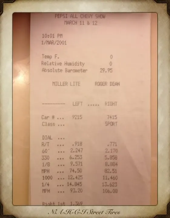

Just for comparison sake. My car made around 290HP at the time and ran 13.6's at 106+MPH all day on street tires.
