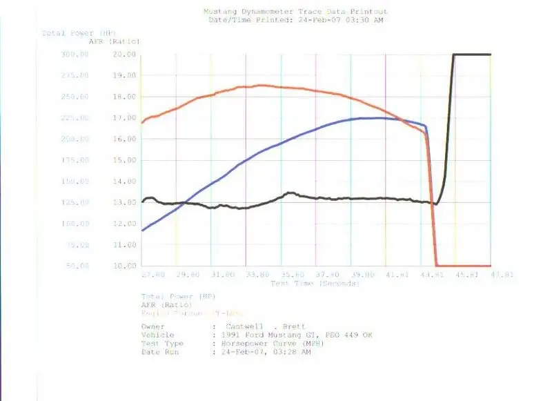

i know whats holding me back, we concluded it was the intake manifold restricting the rest of the engine. on the dyno sheets it starts gaining torque good and peaks too early at around 3500 and then proceeds to fall down. just isnt getting the air.

I can tell you the intake (not just the lower) flows 200cfm which is about 10cfm short of the peak flow of the heads - the intake is not restricting this engine to any significant degree. When you advance a cam, you pull the rpm and power band down and beef up the torque curve, but then it turns down sooner too - exactly what you are seeing. If you'd take the advice given and degree the cam in with no advance or even retard it 2-4 degrees the power band will respond. If you feel it's just the intake, replace it without changing the cam and see what you get..................
I agree with Tmoss. Put your cam in straight up. My stock cam and 1.7rrs makes power to 5600rpms with the same heads and a high rpm oriented intake. You should be right around where Im at considering you have a better cam.
i didntt really think his intake is choking me at first either. but i didnt think the camshaft advance would have such a great affect. and know people have great luck with thumper and tmoss stuff. so i got confused.
i still cant figure out why the car didnt trap more than it did before with the stock engine.
with a bone stock 140k longblock, CAI, pullies, 1.7 RRs, exhaust and gears with a DR i managed 14.1@99 with a 2.0 60' and 13.9@ 97 with a 1.9 60' were my best with the stock engine.

just a reminder my car made 225HP and 270 TQ on a mustang dyno.like i said before, nothing is mechanically wrong. AFR was dead on on the dyno, consistant 13:1 pretty much, checked compression and got b/w 140-145 on all 8 cyls.
and another thing, i have a friend with a 97 GT mustang, SOHC 4.6 with a K&N filter and hpipe and flows on the same dyno made 207 HP and 270 TQ
i figured everything i have done to my engine and having it being new, that it would make more than just 17-20 Hp more than a sohc 4.6 with over 100k miles and he managed to make the same TQ number
heres the dyno sheet of my best run. maybe u guys can see something....
i really dont feel like tearing it down and upgrading, the engine runs good. i would be very willing to go back in and mess with the came timing for sure. but i dont really have the funds to really upgrade stuff. i dont know if mine is running bad or what. maybe its fine and i am crazy, but it still gained no mph, maybe i just need a tire to hook good. because i was pretty much launching off idle. anything more would spin the tires hard.

That intake and head set up should pull better. If theses are the parts your running, and you are confident with your driving, its in the tuning. Follow what TMOSS said- back the cam down. The engine is nothing but a air pump. If your exhaust cant move the air, the heads and intake cant do their part either. If you want 12s, it all has to work together. Why blow more money when you just need to tune??

My money is on the cam timing as well. You definately don't need to ADVANCE a ford cam. That cam advance is definately hurting your top end...how much, I'm not sure, but I bet it will probably be noticably different when you degree the cam properly.
