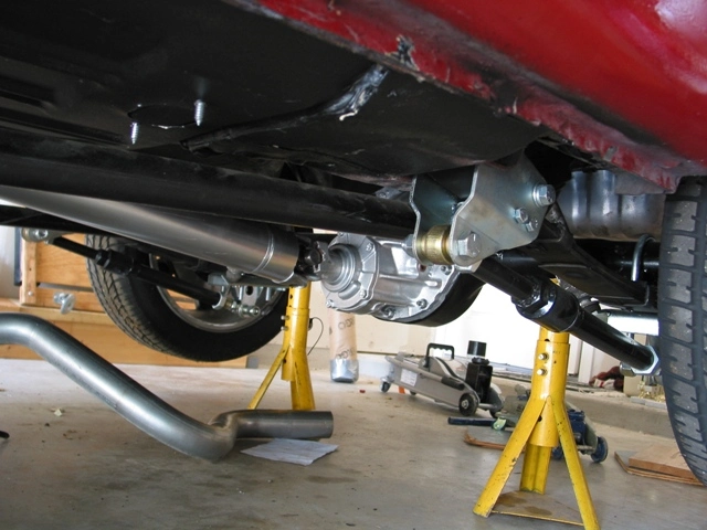

I guess the GW SFCs could be different, mine are about 5 years old now.
The rear portion connects to the curved part like you said, the front connects to the straight part. The bar runs right down the middle, and the gap was too small for me to get the trac-bars in there. I looked for a picture and only have this one...you can see how tight the rear of the SFC is and how close to the rail it is.

Same SFC's. The mount slips into the gap you mentioned and is welded to the flat part, then hangs down next to the SFC. Similar pivot point to yours (Cal-tracs?).
Looks like you're doing a clean job BTW.
