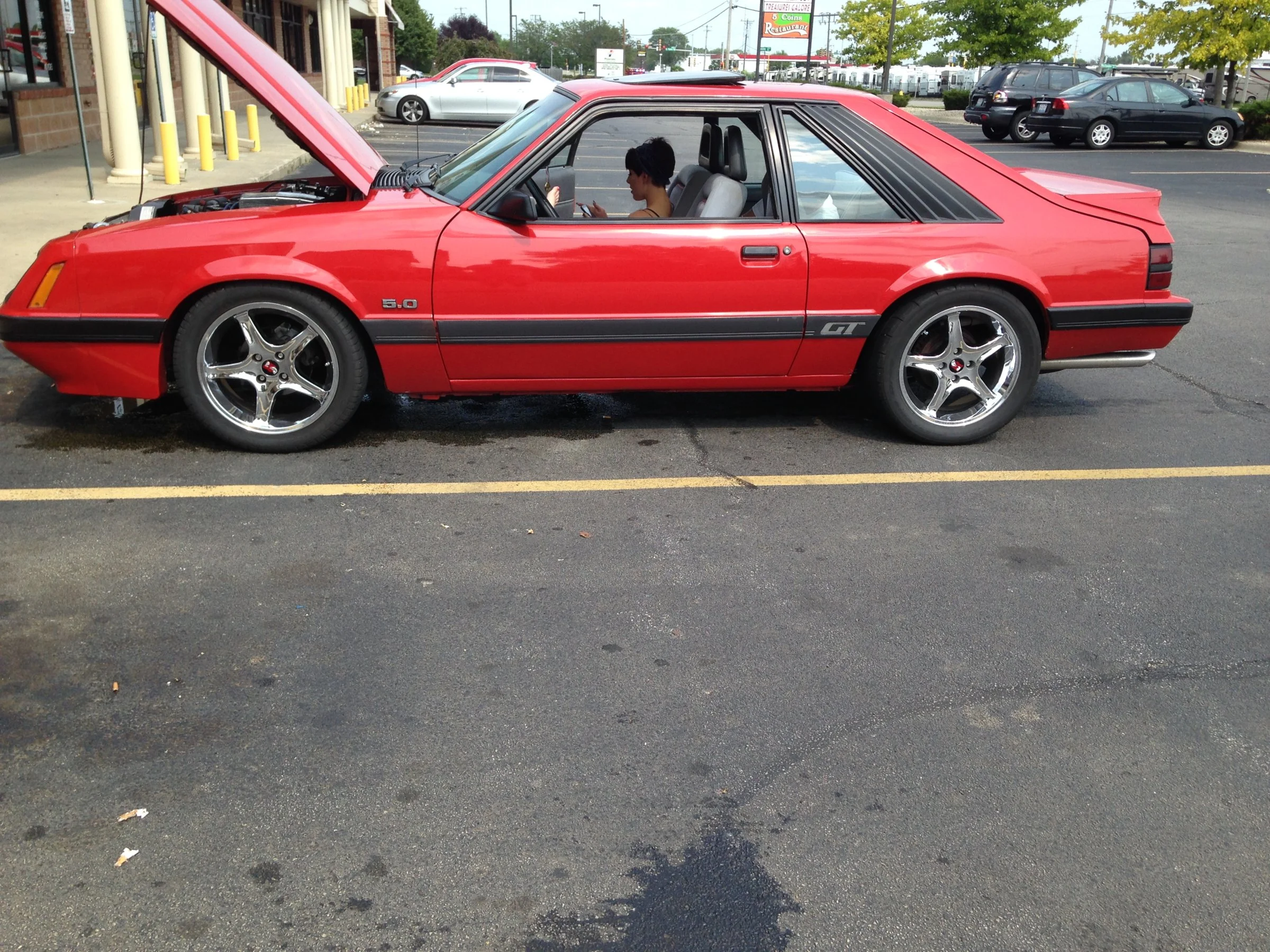

My 86 has 150# maximum motorsports coilovers,cc plates,frame connectors,and rear control arms. Using the strange adj struts and shocks and team Z rear springs. Very streetable and rides way better than the eibach pro kit(which this system replaced). Now it isn't going to handle as well but for every day driving it works great IMO. Just not going to be able to throw it around in the curves(if that's something you like to do). I haven't even turned the struts to full soft-just using the street settings. It weight transfers very well and helped the straight line acceleration(still slightly spins in first and chirps 2nd/3rd gears-and that's with Nitto 555r 275/40-17 drag radials). You probably have 30-45 more hp than I do. This is the best suspension I've had on my mustangs for this type of driving(street/strip-straight line). I ran the eibach stuff for only 2 summers-maybe a few thousand miles. Liked the stance..not the ride/straight line performance.

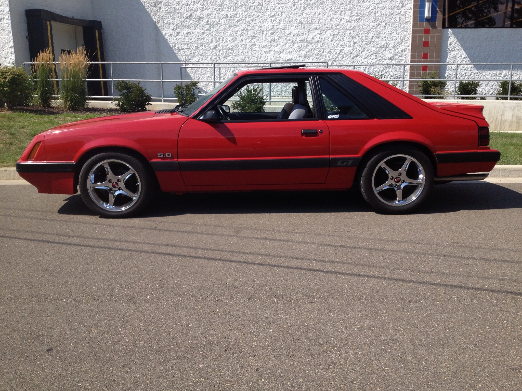

My car drives just find on the street . I think it sits decent too
