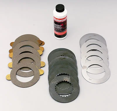

Here is the trac loc rebuild kit... $50.00
http://store.summitracing.com/defau...earchinresults=false&N=0&target=egnsearch.asp
I am having this installed when I get 3.73s this summer... :nice:
